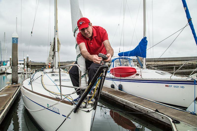

I have also seen one make to be pinned to each side of the bow with a bob-stay to hold it down. Here is a photo I found of the concept. There is a company that makes them out of carbon fiber and I have seen several home made versions.

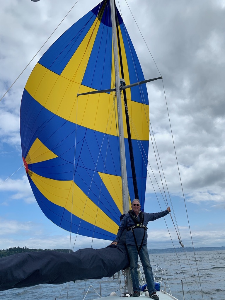

I run an asymmetrical on my boat, using a tacker and a sock to launch and retrieve the sail. It works very efficiently, and the sail does not have problems back-winding on itself.
Here she is in about 7-9 knots of winds. I just launched the sail for the first time.

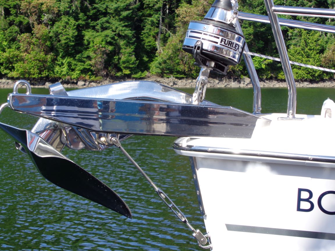

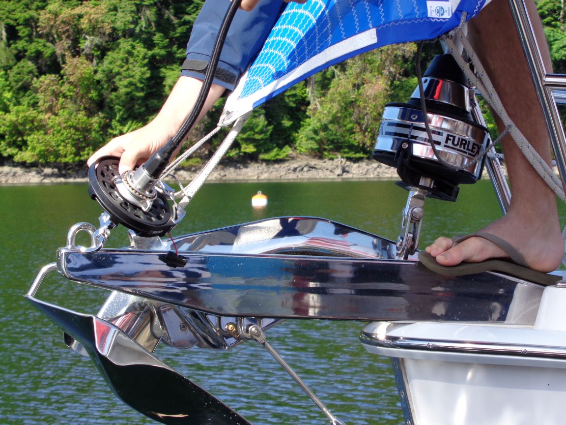

Not great pics but the best I have and they may give you an insight as to how this 2014 MH37 was rigged for a top down furler. I do know the bow sprit was custom made and as you can see it has a small bobstay attached to the bow.
