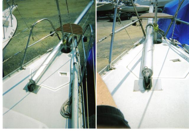

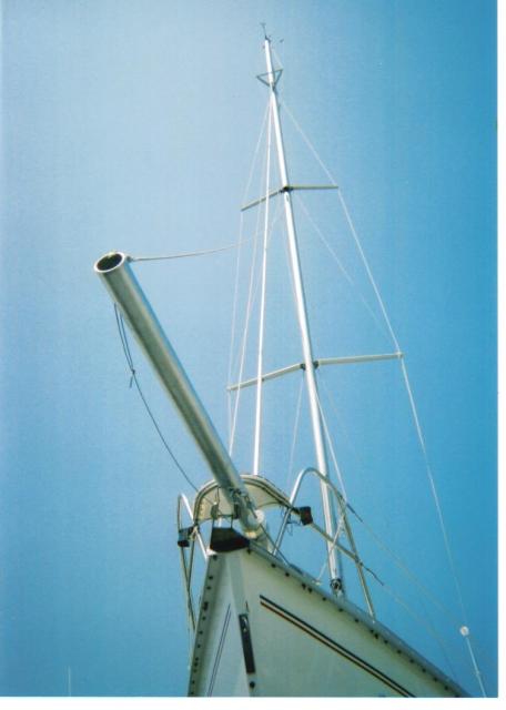

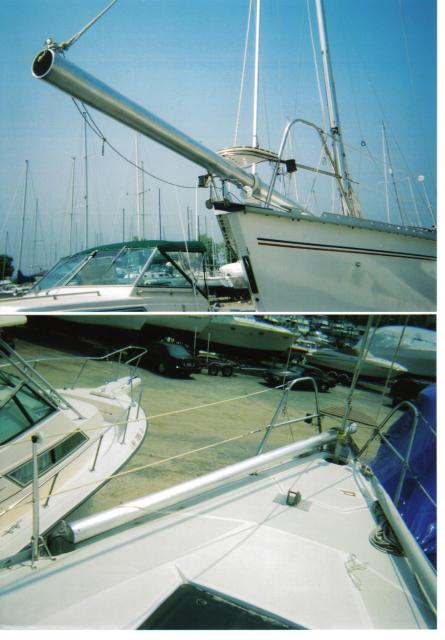

Asym's are not meant for sailing DDW. As the breeze gets lighter the boat needs to head up more to maintain good apparent wind speed and angle.
Using a retractable sprit is a big advantage over the anchor roller. I built mine to allow a 5.5 foot extension and still allow use of the anchor locker when the sprit was retracted.

Alan: I know Asym's are not meant for direct downwind and usually sail about 120. I am very interested in your sprit. Is that a wheel on the inside end of it? What halyard do you use to support the top of the extended pipe? The photos did not reproduce well when I clicked on them. It looks like it locks away to port side when not in use. Do you have a block at the end of the sprit to run the foot line back to the cleat on the boat? I would love to see better quality pics etc cud you send to dougros@videotron.ca. Still time to build for this year!!!!!!!

Roan, The outboard end of the sprit is completely unsupported, there is no 'halyard' needed to support the sprit. I designed it to withstand a 2500lb lifting force and the turning block at the end has a breaking strength of 1500lbs so that it would fail before the sprit. I'll try sending you some pictures. If I can be of any help, don't hesitate to contact me.
