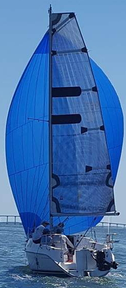

Nice - really like the flathead main. Who built your sail? Did you measure?
Re: hardware - turning blocks to winches or cams on the C25. Don't think they fly their asym above 10 knots.
May 25, 2018
28
Hunter H240 Hillsboro Inlet
That is a Doyle Stratis built in New Zealand. My local loft and I measured the rig three different times before I thought I had the rig tensioned properly. Then when we sent the measurements to the Stratis factory they questioned the prebend in the rig before they would build the sail so we measured again. Really worth every penny.
