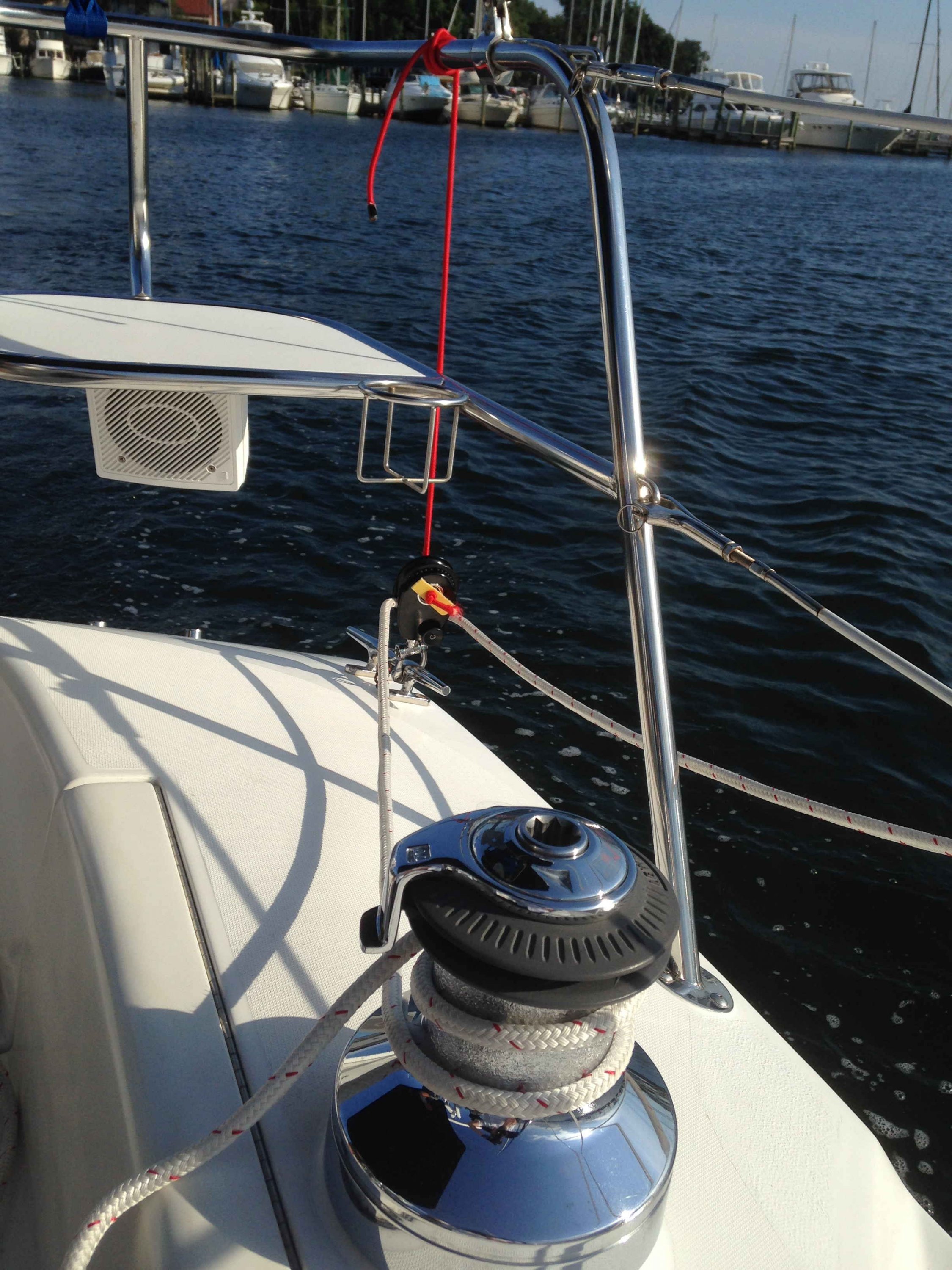

Here is a picture of my spinnaker sheet snatch block on the rear cleat. The red bungee keeps the block from whacking the deck. There is a clean run to the winch. The picture was taken as we were departing the marina for the Wednesday night fund race. Before anyone says anything, yes, I know the sheet is around the winch in the wrong direction. I fixed it after the picture was taken. I've tried to explain winches to the admiral and how to wrap the lines around them. I've tried for two years. I just fix them after she tells me it is ready to go. Bless her heart!
The sheet diameter is 5/16"
