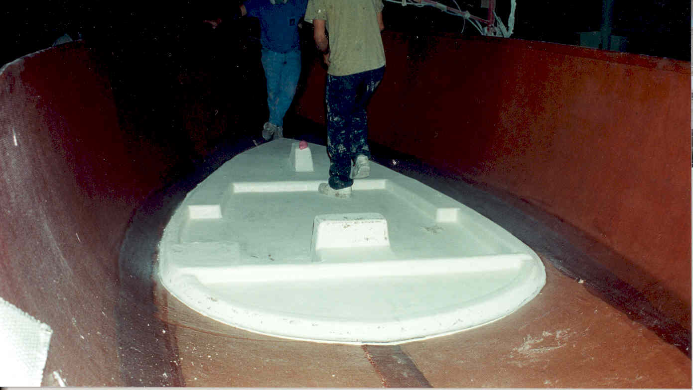

When Hunter built the 260, all fiberglass was precut and laid accordingly to strict specifications. Therefore, all the boats pretty much weighed the same leaving the factory as i checked it out on occasion during transport to my dealership.
