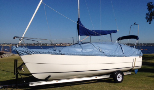

Here you go: Full deck cover to use for both trailing and mooring. Lies flat over the deck for trailing and can be drawn up for water runoff while mooring. Has 5/16" elastic shock cord in the hem to hold 6" under the rub-rail, tie-down points, heavy duty nylon zipper, mast collar with drawcord closure, and flaps that snap around stays. Reinforcements are at back corners, fairlead areas, cleat areas, and splashrails. Does not fit over the boom when boom is in crutch with mast up. Store boom in cockpit. To use cover over the mast for trailing requires that the mast be no higher than 15" above the deck where the mast steps and no higher than 3" above the transom. $1042 plus options.

They are challenging to put on when you can’t walk around them. Breathing wise. My wakeboard boat has a custom cover made from sharkskin brand fabric ( cheaper and sunbrella) and it breaths amazingly well. It’s put away wet on the boat lift and has never has a mildew problem.

The sailboat cover in post #9 can be purchased with multiple vents to ensure adequate circulation. Moreover, the cover can be put on in a shallow area near shore or ar a dock and then moved to the mooring by your dinghy or other means that is convenient.
