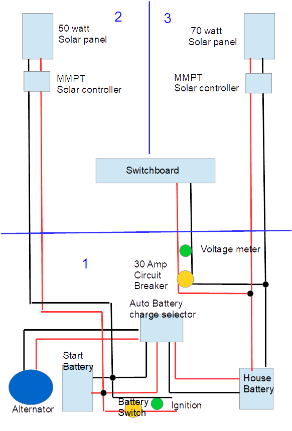

WE have: a chart plotter, auto helm, refrigeration, pressure water, radios and a windlass that all could be demanding on the batteries. Obviously the windlass is a part time use and only when the engine is running. To support these, there is a starting battery and a house bank of 3. I have a 1,2,BOTH/OFF switch for the starting battery and a separate 1,2,,BOTH/OFF for the house. With each switch the number 1 position sends power to the appropriate place. No engine charging goes back through the switches. Instead, the alternator sends power to an isolator. This keeps the separation complete. Should the starting battery fail, its switch could be set to #2 and the house bank switch also moved to #2. This would allow the house bank to start the engine. Regardless of the switch positions, the charge is going back into each bank. And just to make things interesting... the solar panels each feed to a battery switches that are only 1,2 OFF. Position 1 is solar and 2 is shore that feeds from a Xantrex charger.
It sounds like I have the same setup as you with two 12BO switch with position 1 for start and house. If your system has a heavy wire that connects the #2 terminal on both switches like mine is, then you have a misconception on how to get emergency power from the house to the starter. To start the engine from the house battery only and have it not connected to the start battery you do the following. Turn the start switch to position #2. Turn the house switch to both. This way, the power comes out of the battery and into terminal #1, it is then sent out position #2 because of the both setting. Then the power goes into start switch #2 and to the starter.
If you turn both switches to #2 position, neither battery is connected to anything because they are both connected to terminal #1.
