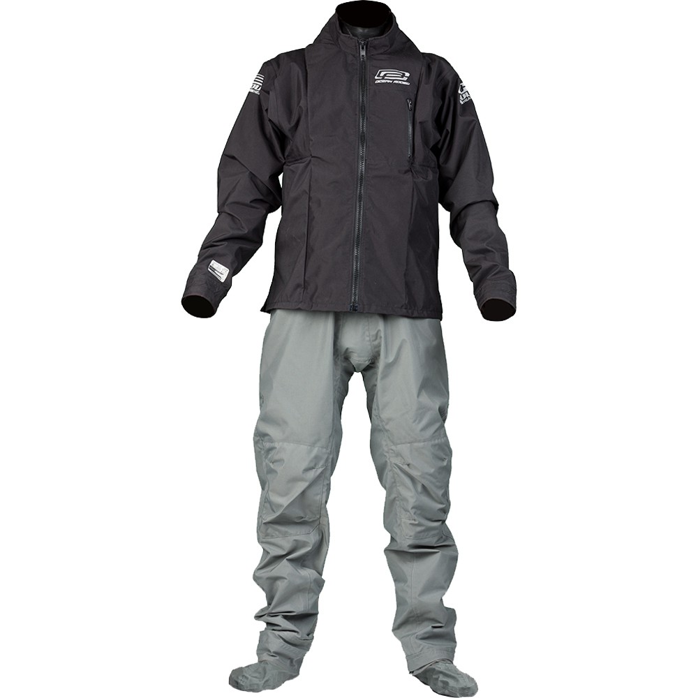

23,129
Survival suit.
Also known as the Gumby Suit. Warm and longer immersion resistant.
Or you can try..
which you can wear sailing solo. You still have some protection but you have a lot of mobility.
