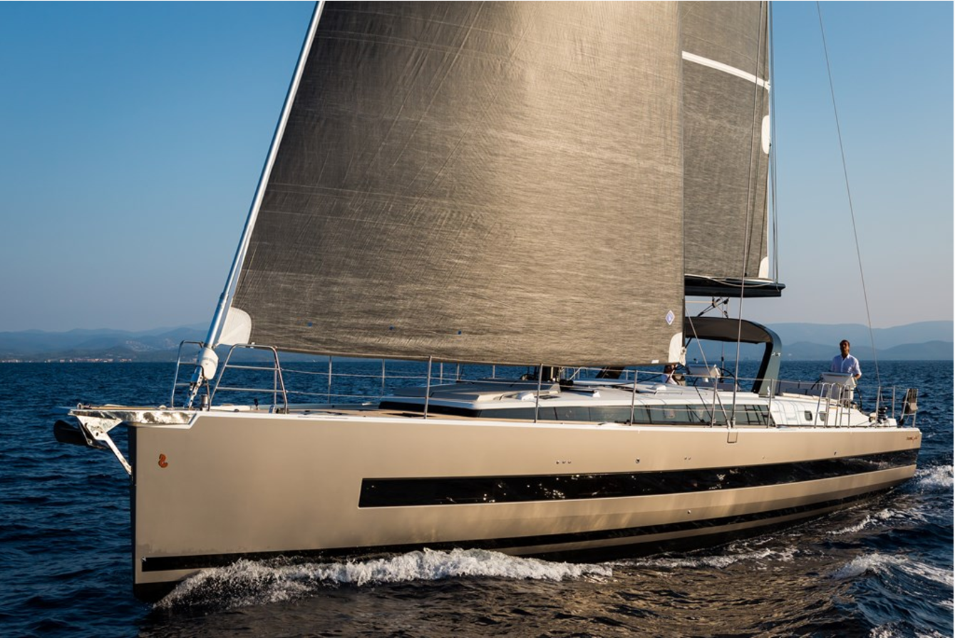

Examining more photos of the Oceanis 63 you see that the mainsheet system has two lines attached on the arch, either side of center. The triangle set up would permit center boat and more control of the boom. Just not the infinity control of a traveler.
It's the same line with two sets of blocks creating a bridle to spread the load.

The arch could have a traveler on it in terms of ergonomics. But, maybe with the forces involved it isn't or couldn't be engineered for a traveler. But check out the attire of the crew and I guess you can tell who the is being marketed to. They do look fabulous. They don't look concerned about the angle of attack for the main.

That is a good looking yacht. And the sails match the hull. My wife would love that! I don't think that arch takes anything away from the looks of the boat. My problem is the lack of sun shelter.
That arch has mad skills. Buy it the way you want it. I for one would love to drive this thing upwind at 10 knots. Yum.
PS - if you can pull off hats like that couple in the last pic, you don't need shade.

The potential for significant swing on an accidental jibe on the Oceanis 63 looks like a catastrophe in the making. I'd not sail that rig wing-on-wing without installing a substantial preventer.
