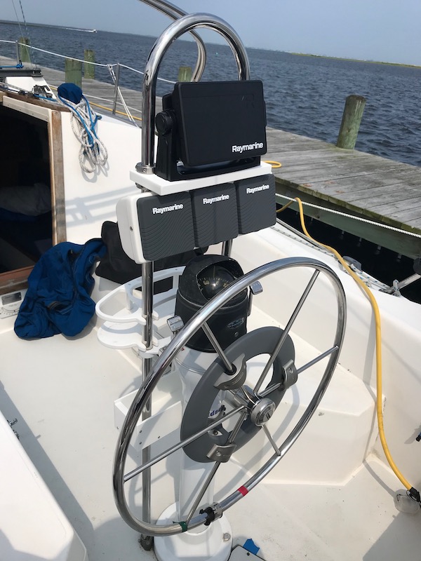

This weekend I installed two RM i70S displays and a P70S control head into my existing nav pod. The pod also contains a SeaTalkng 5 way connector, T connector, spur cables and the Axiom 7 CP power cable and spur cable.
The nav pod is a bit cramped and the suppression ferrites on the spur cables of the i70S and P70S displays complicate laying out the cables so I don't have to sit on the pod to close it.
The suppression ferrites are user installed. I was wondering if I could remove them without affecting the operation of the instruments.
Are they really needed?
