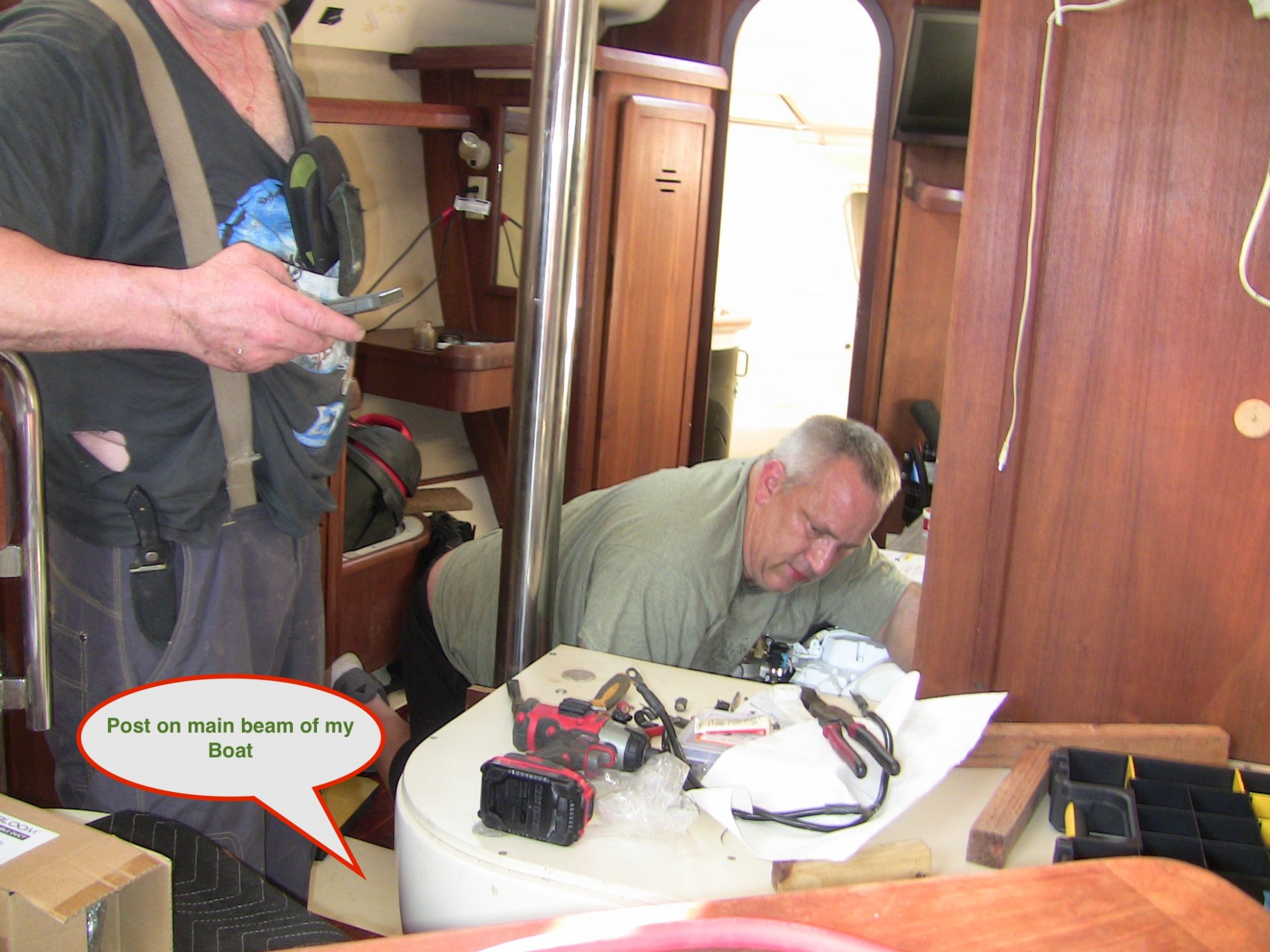

My Compression Post is on the main structural Beam which is good Design by Hunter.
