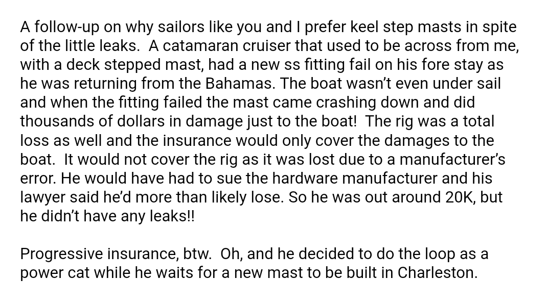

Regarding keel stepped vs deck stepped masts, I just received this email from a friend of mine.
