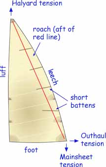

In model sail making, i found this out on day one of the first design with roach. My full length batten ruined the sails as they were just taped on=flat batten=flat sails. The partial battens need to just go past the "red line".

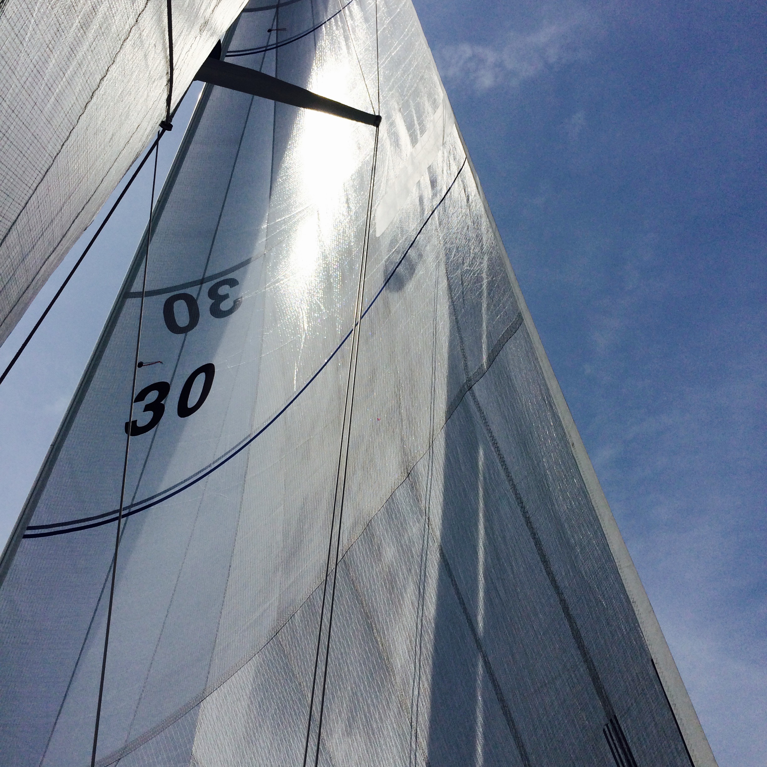

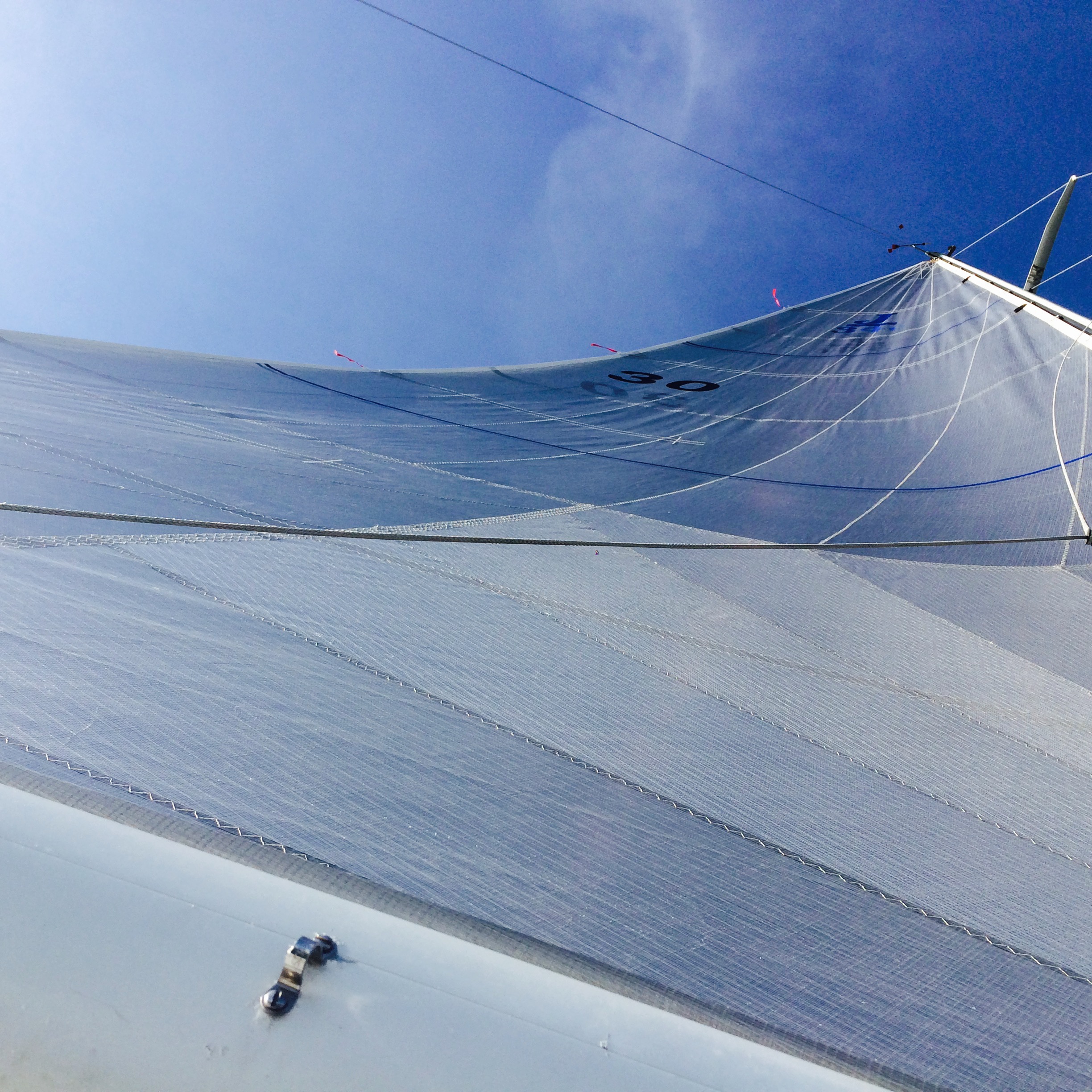

Or you could buy a new sail. One thing I love about Dacron sails is that you can adjust them with running rigging to a great degree. The great thing about plastic sails is that when the shape is right they stay the same. On the other hand, if the shape isn't right, it will never be. How's this for a flat exit?
