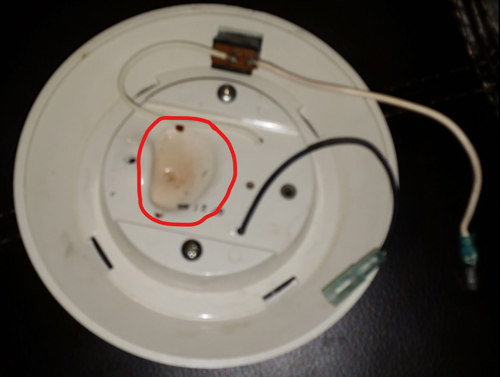

I had a similar problem with the arch light, turns out the connections at the light fixture were riveted on and had built up some corrosion. Try accessing them and move them around and see if that helps. I wound up replacing the fixture with a dimming LED red/white fixture and love it.

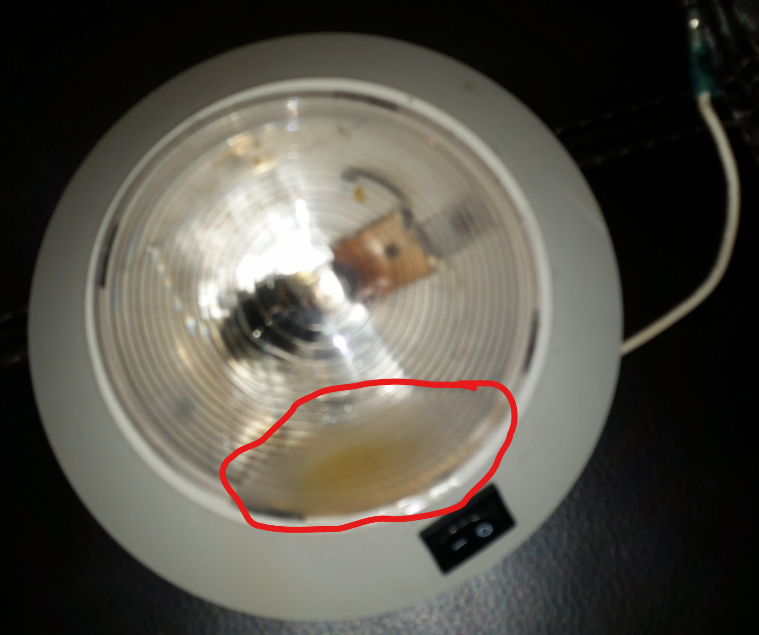

Mine the power is connected to the dome light in the lazarette, it was just a bare wire that was stuck in with the male plug for the dome light. Check and see if yours is the same as it may have pulled loose. Also, watch out for that dome light. I had that lazarette so full of deck chairs and other stuff that one of the chairs shifted and turned on the dome light. It was on so long that it started to melt the plastic lens and housing of the dome light. Good thing the bulb burned out before it caught fire.
