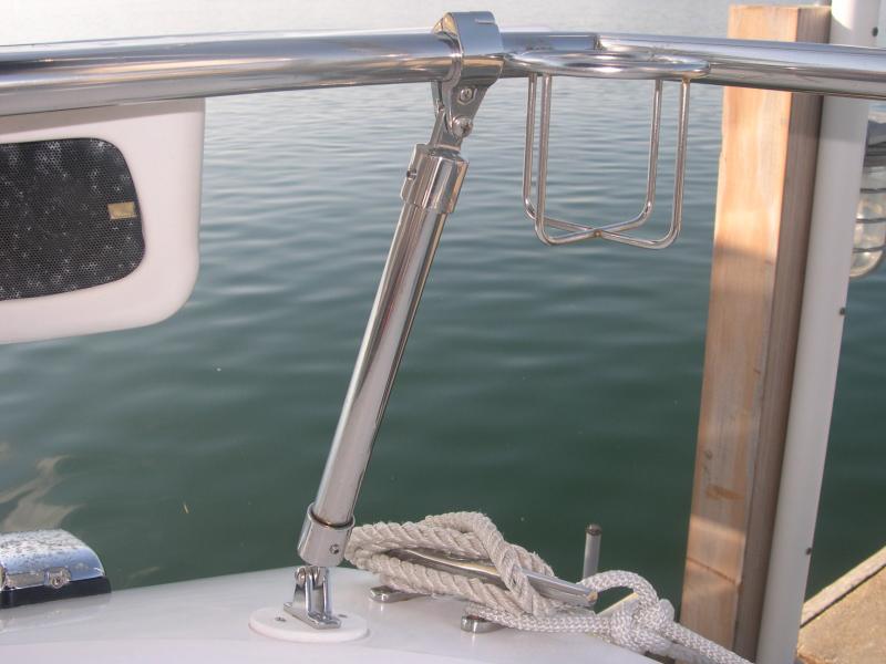

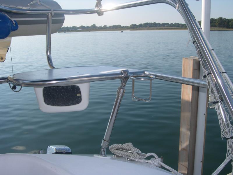

Here are a couple of photos. One is just the arch from the existing stern rail. The other is a full arch mounted to the deck and has davits.
You could also go with an arch like these, they have put them on C350's but I don't think any C310's yet.

Hi Russ, Tom, Stu, JK and others,
Oceania(photos in some of your posts) is actually our boat and much to our embarrassment and horror was dinged. Neither boat saw the other.
We had all the stainless from the port side ripped out, pulpit torn off at the bow, port pushpit destroyed and our arch carrying two 80watt solar panels torn off on the port side. Port stanchions pulled out, broken or bent and some of the stb ones bent out of shape. The lifelines held it all, plus o/b, from disappearing to the bottom of Queen Charlotte Sound and we limped back into port and untangled the mess. Not pretty!
Minimal fibreglass damage in the scheme of things, just where the other yacht rode up across our toe rail and where all the stainless fittings pulled out.
We have never been terribly happy with the design of the arch, so are thinking about alternatives, and there is the issue of the inflatable, we normally tow it or carry it on the foredeck. In the photo Stu and JK posted we had the dinghy lashed to the stern rail as we were not carrying the outboard. I thought it worked well, but he who must be obeyed was not keen.
Our thoughts are Weaver davits, plus an arch, but is there room for the outboard on the stern rail? Or, conventional davits with a solar panel on top, but do they put us into a longer, ie more expensive category for a berth? Also, handling with that extra weight out the back?
Lots of pondering going on so your input has been invaluable. Thank you all.
