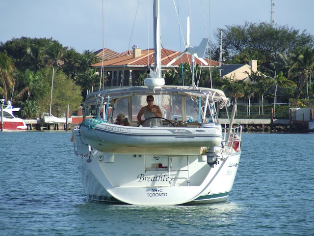

When I ordered my 393 in 2004 I specified an arch as I had seen the Beneteau arch for the 423. It turned out that B did not have an arch for the 393 but the 423 arch would fit with a bit of shimming on the transom (the transom angles on 423 and 393 are different). So I have a 423 arch on my 393. I believe B had an arch for the 473 when they were introduced.
I carry a 10'06" AB Lite RIB with a 15hp Yamaha 2 stroke on the davits.
There was a lot of discussion (and pictures ) of the arch on the 393 site and, as B no longer had any in stock, a group got together and ordered the arch from the original Florida manufacturer as the price was much better than the 5 to 8K many had been quoted. Most of the pictures are in the "Breathless" folder on the site.
I would first contact B to see if they have any 473 arches in stock.
