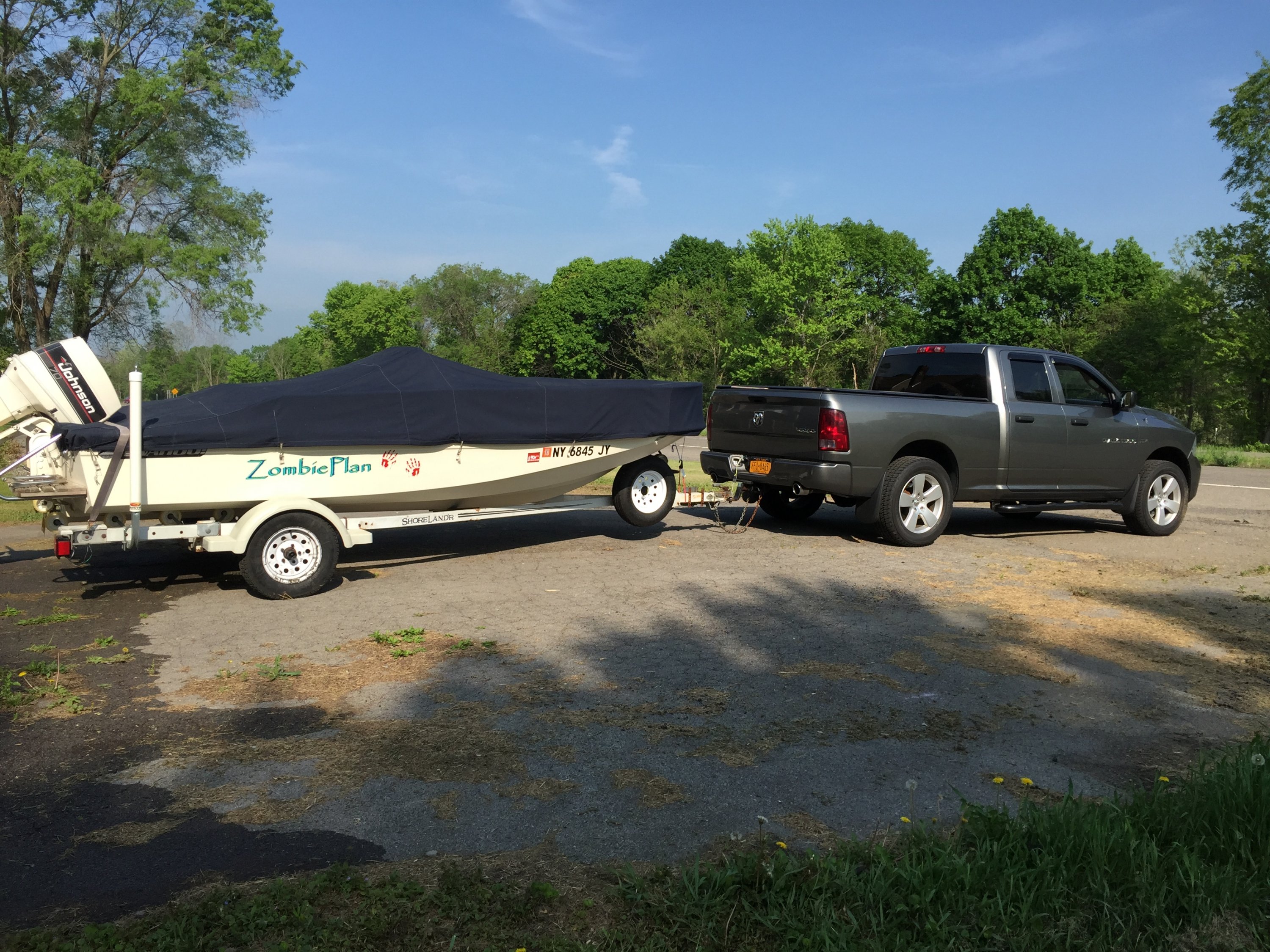

I use DIY lettering to create cool names for my boats.
The first is the name for my new trimaran!
