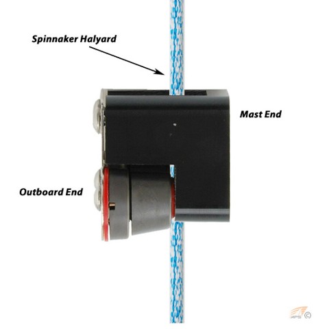

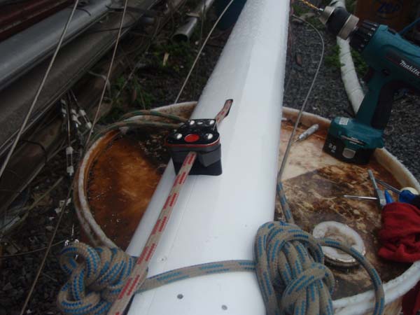

Easy, use a Halyard Parking Bracket.
It holds a Harken 150 cam cleat upside down below the mast exit. After you jump to (close to) full hoist, you simply pull the halyard up and into the 150. Once the pit person pulls it tight with the winch, it automatically pulls down and out of the cleat.
All good race boats use them (normally for Spinnaker's) but it would be perfect for your application.

Cool! I found a bit more illustrative a picture of the device. I'll probably try it out.

Got a link to the supplier on that bracket? Haven't seen that inverted application before.

I like that parking bracket, except it looks like one would have to go to the mast in order to release the halyard when dousing the sail.
Nope. That's the beauty of it. When you pull the halyard tight with the winch, it pulls it down and out of the parking bracket and frees it automatically.
It's great for racing with Spinnaker's, because the mast person is always much faster than the pit person at hoisting. This way when they see the mark on the halyard meaning it's all the way up, they lock it and they're done. The pit person can pull it in more or less at their leisure.
