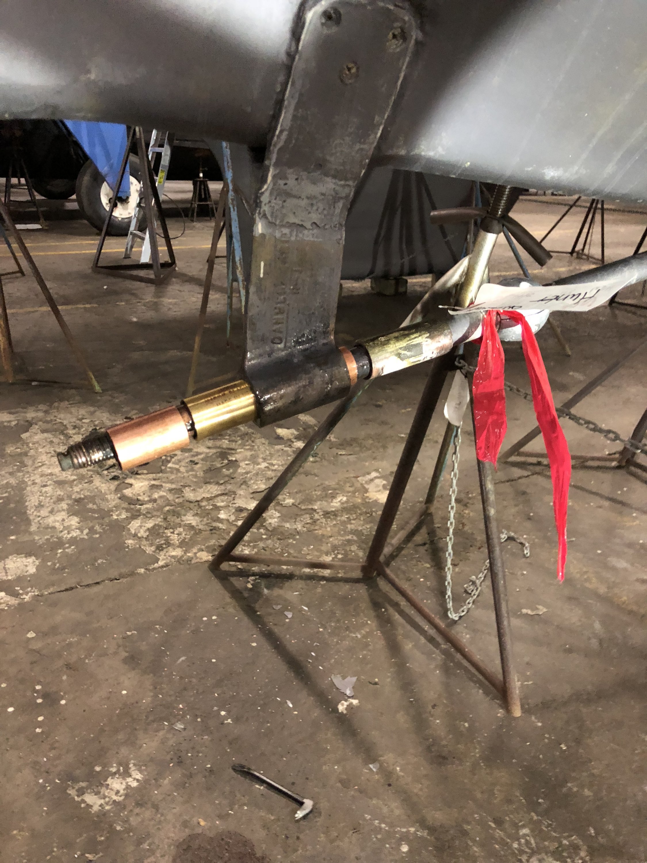

Did that job last spring. Made my own tool with a couple of pieces of plate steel and some ready rod. I used 1/2 in rod but 5/8 or 3/4 would be better. Didn't pull the shaft but the prop was off as I was changing it anyway.IMGP0010.jpeg

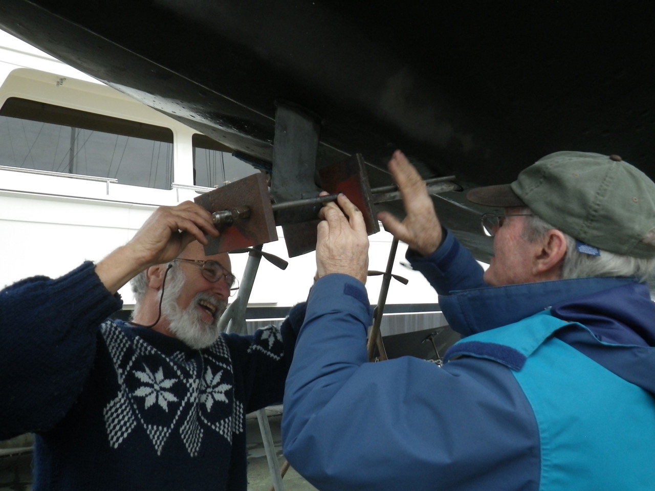

I don't remember how much it cost me back when, but it was far less than the $400 you mention. I went to a shop and had them make me a tool. Prop has to be removed but the cutlass bearing can fairly easily be removed and a new one installed. I'd loan it to you but I'm in Florida and the tool is at my house in Montreal. Here is what I did. Good luck

Nice pdf file, Claude. It looks like you could add two more threaded rods to ease the wear and tear on your two rods.

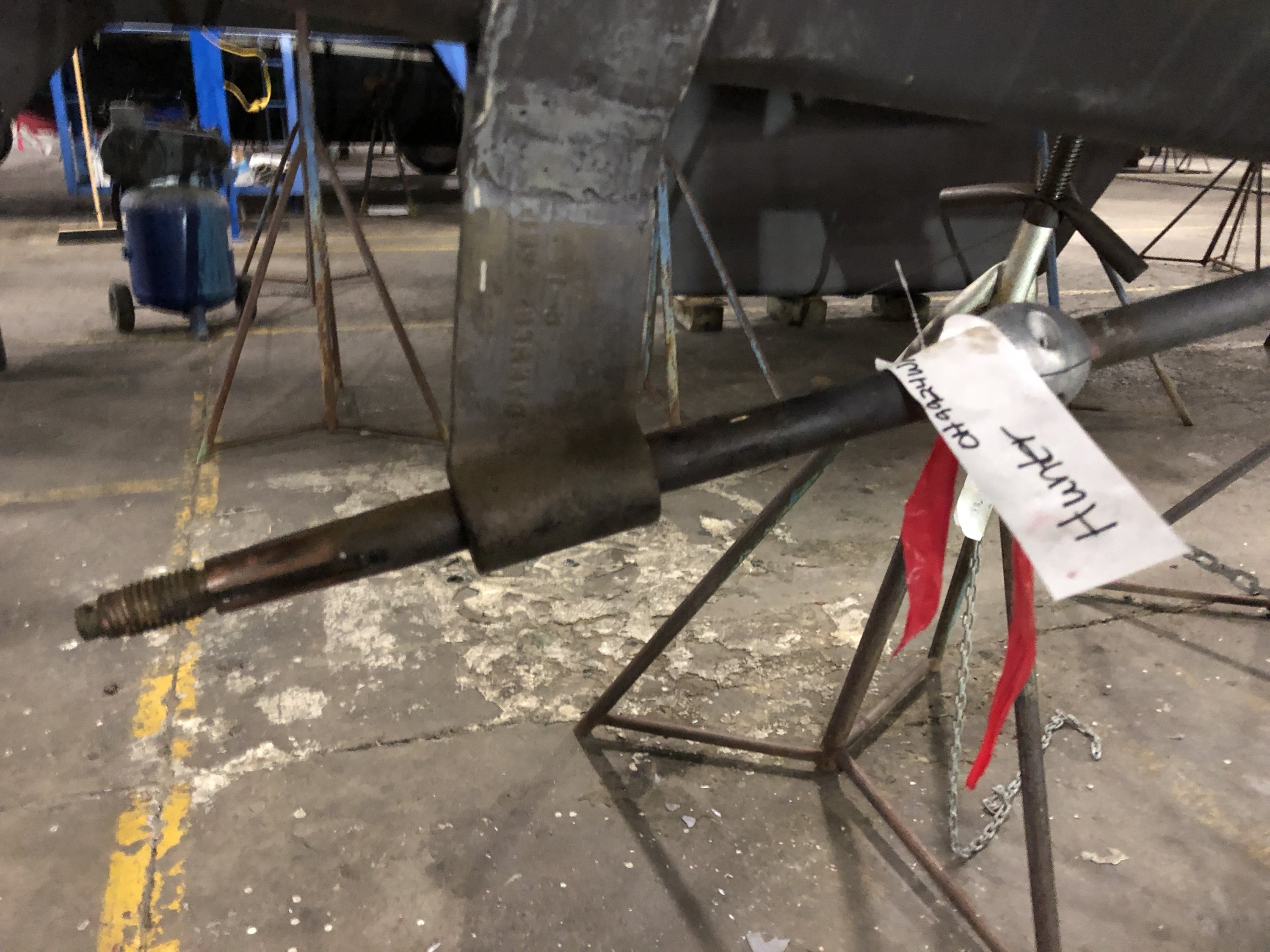

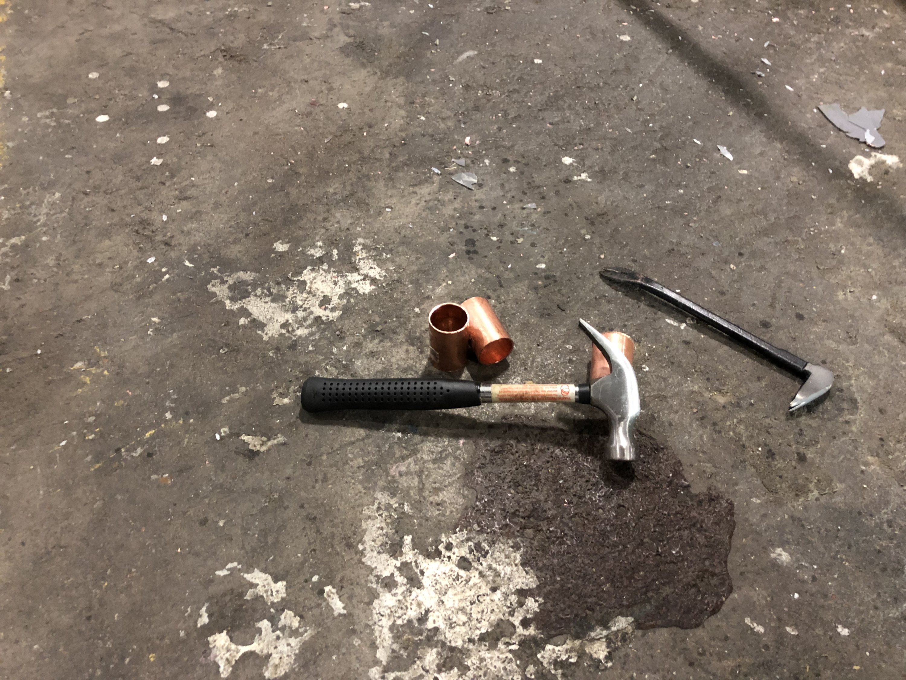

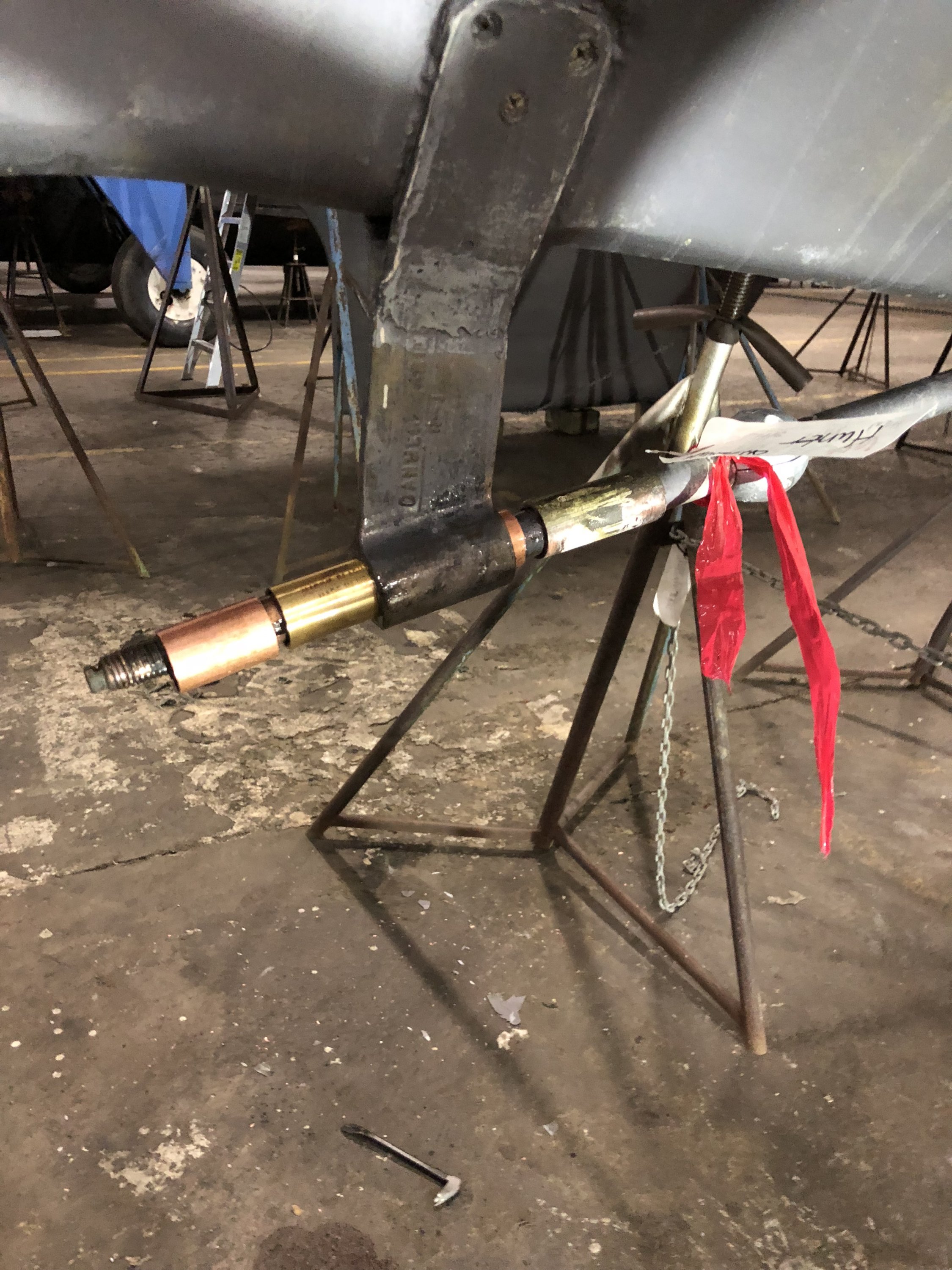

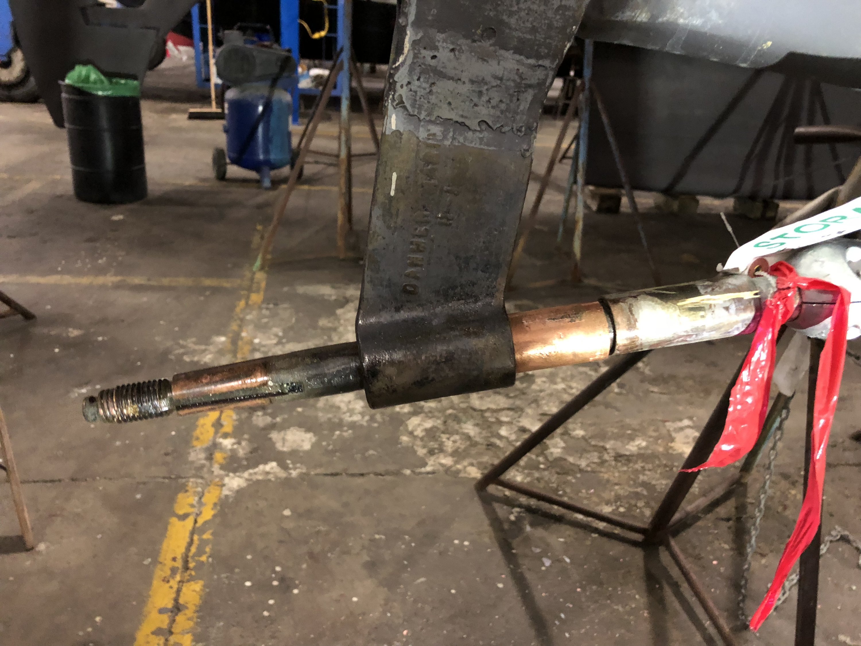

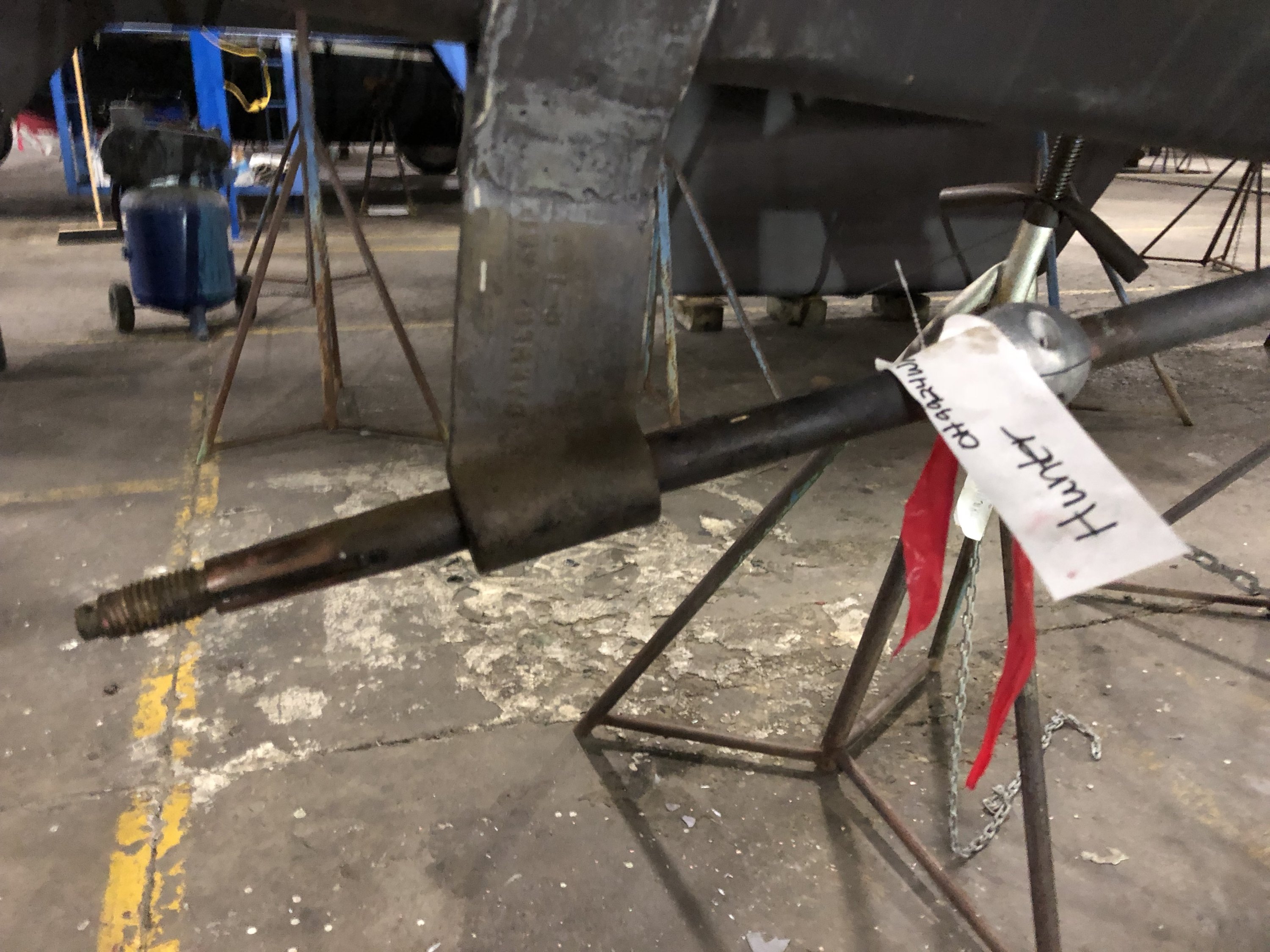

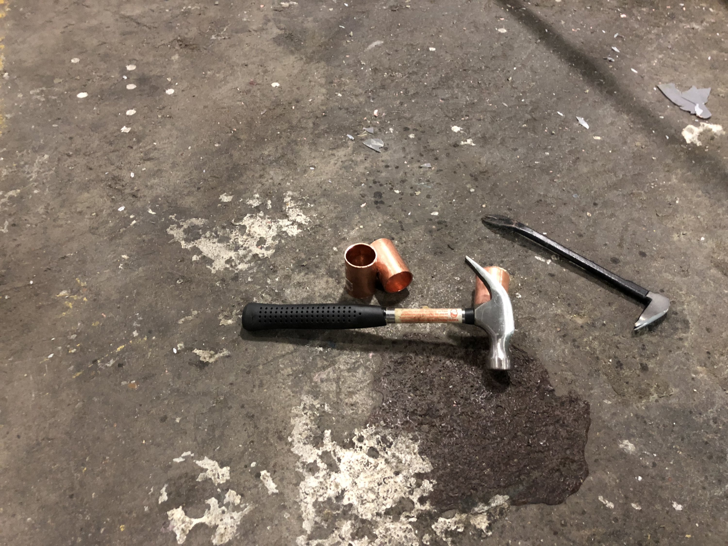

Jan 29, 2017
2
Hunter 30 Sandusky
Thanks for all the advice guys!
I got the bearing swapped this weekend. Ended up doing my buddy’s Catalina 30 while I was at it as well.
Here’s what I did:
I soaked the old bearing in penetrating oil to see if that would get the juices flowing.
I bought some copper couplers for 1 inch copper pipe. Since my shaft is 1 inch, they were perfect ID and OD.
I took the Hazard Fraud heat gun to the whole mess and got it heated up real good to open it up just a tad.
Then I just stacked those couplers around the shaft and gave them a good smack with a hammer. Knocked the bearing right on through and then dremeled it off.
Tapped the new bearing in the same way.
I’m pretty sure the ingredient most necessary here was the heat and the legitimate rap with a hard hammer with the energy traveling directly to the old bearing.
All told, the parts cost me less than $15, and not much time once I was comfortable with what I was doing. Knocked out my buddy’s bearing in 10 minutes.
