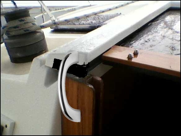

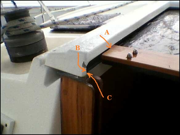

Latest idea....
Thanks. Yea, I've actually torn the whole thing out twice, and yea, it's probably leaking around the traveller and/or a loose screw or two, but here's where I'm getting lots of water. I gotta do something, it's running down on top of the motor, so I have rain buckets out. Anyway, when I close the hatch (and I was very procise where I put the point of the arrows, but, ) A hits B (as you can see, I've knocked off gelcoat, yipe) and the rain goes down towards C and then runs inside. I put weep holes in the bottom of the slots for the hatchboards and even put a coat of resin in slot. Im thinking of doing what I've mocked up in the other pic, as a solution. Idea? Thanks, Keith

KB, I don't know what to tell you here because my hatchway isn't configured like that. Mine has/had just a molded-fiberglass hatch sliding in teak rails outside a molded-fiberglass coaming (part of the deck). I replaced the teak rails with a new system and ended up having to add a stick on top of the molded-fiberglass coaming as the hatch had ended up riding too high there. You have those fiberglass angles or panels above the hatch slides. I don't know why Hunter did that; the way mine is, even with other materials used, is really the best basic system. I looked high and low at boats about local yards before I decided how to remake mine and still got it wrong.
I really wish that sometimes boatbuilders would keep with tried-and-true over attempting to reinvent the wheel!
That H37 is overly complex and I can see where your leak is coming from. The hatch needs to come farther aft, for the teak along the aft edge to end up under the two white fiberglass pieces. Only this way will the Lexan part be fully covering the top of the hatch boards. Why this isn't happening I can't really tell.
I don't like your idea of adding a piece of hardware; and I don't like the idea of relying on a canvas cover to seal out what the hatch should be better at sealing out. Reminds me of the modular house we once had with the front door that the *professional carpenter* who sold it to us did not know how to set right. I attempted to fix it myself and found he had nailed all the frame and trim pieces good and solid where they lay-- and on a modular house everything moves before it's settled for good. We ended up buying a really good storm door, which sealed out the weather-- but this isn't really a 'fix', only a bandage over a (literally) gaping hole.
You might consider taking those fiberglass pieces right off and getting the hatch to work without them. Then, fashion something new or refit those pieces into where they should be. And, in future, maybe don't let people stand/kneel/sit on the hatchway edges!
