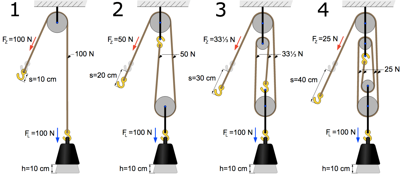

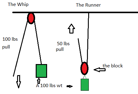

In the outhaul you need to reverse the direction of the line. Using the block to add power with minimal to no friction (180º turn of the line reduces the force required by 50%)
Use of more than one block (pulley) and you can really reduce the fore needed to adjust the outhaul.
That does not happen with LFR as they add friction to the system when the line turns greater than 110º.

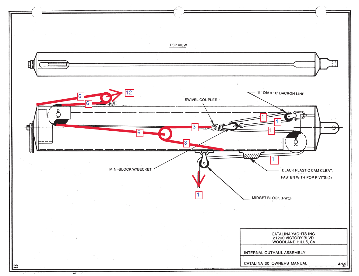

I modified the factory internal 3:1 outhaul on my C30 to be a 12:1 by adding one internal cascade block and a second cascade block on the main sail clew. I used a good quality bearing block for the internal and a high capacity sheeve block for the external due to it having the full 12:1 purchase load on it. The 3:1 still uses 1/4" dacron double braid because it has limited load. The rest of the system is 1/4" Amsteel.
