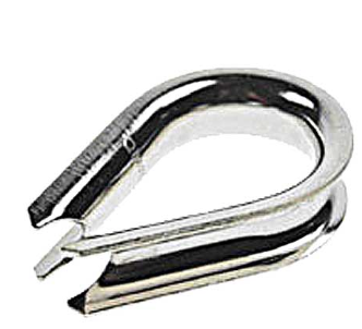

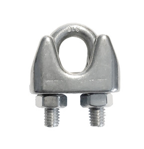

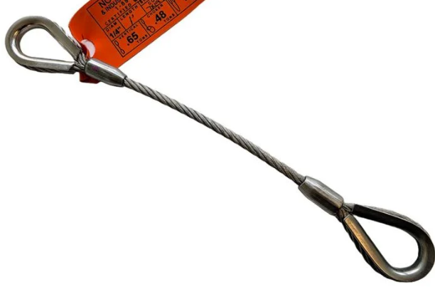

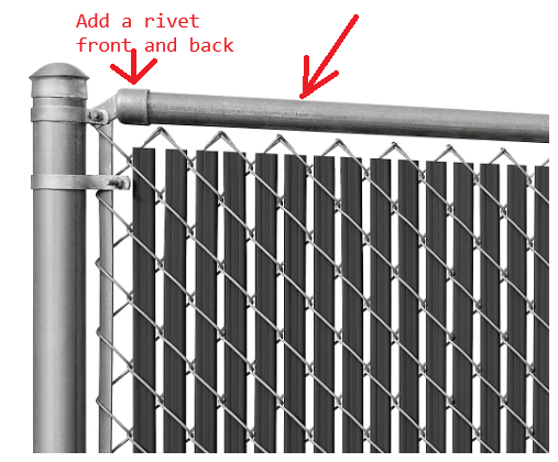

I’ve built a gin pole for an H26 before. The standard chain-link fence poles sold at Lowe’s and Home Depot are the same diameter as the factory Hunter gin pole. Add some stainless steel cable, a few thimbles, and wire nuts, and for under $30 you can make a gin pole that’s essentially identical to the original Hunter version.
Make something like this to go on the end of the pole to clip your halyard to and use some ratchet straps to make baby stay to stabilize the mast on the way up. Review the owners manual to see how the baby stays are used.
