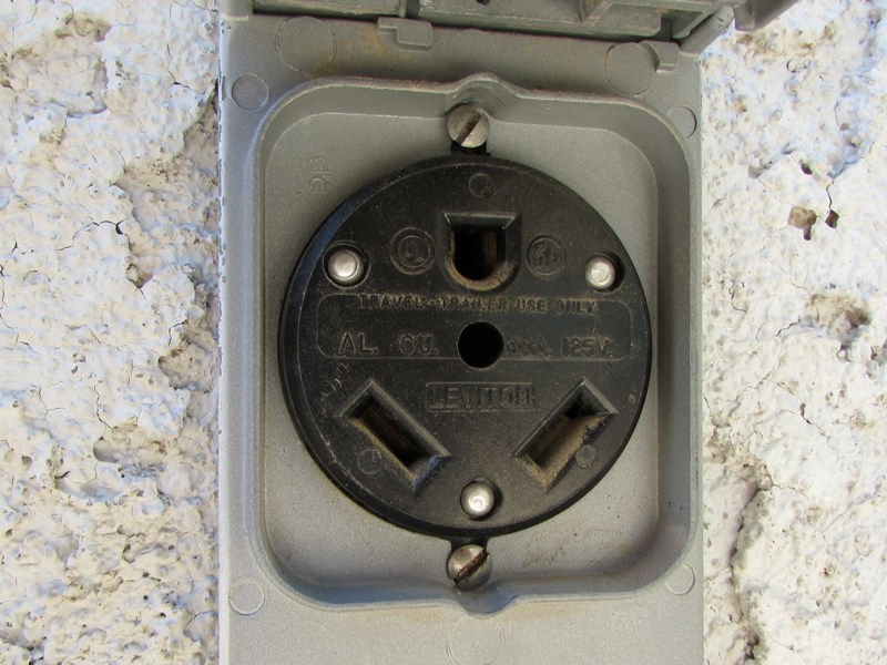

It has a 30 amp "RV" plug,
Im not sure where this thread went. but this was sort of interesting regarding the "RV" plug. I have an RV plug on the side of my house and its 110 VAC 30 amp. Ive opened it up and its just two 110VAC black/white/green wire sets connected together at the socket going back to two likely 20 amp breakers. I think the 110VAC 30 amp RV socket has the same set of B/W/G wires that the 110 VAC 30 amp twist lock L5-30 plug has but am not sure.

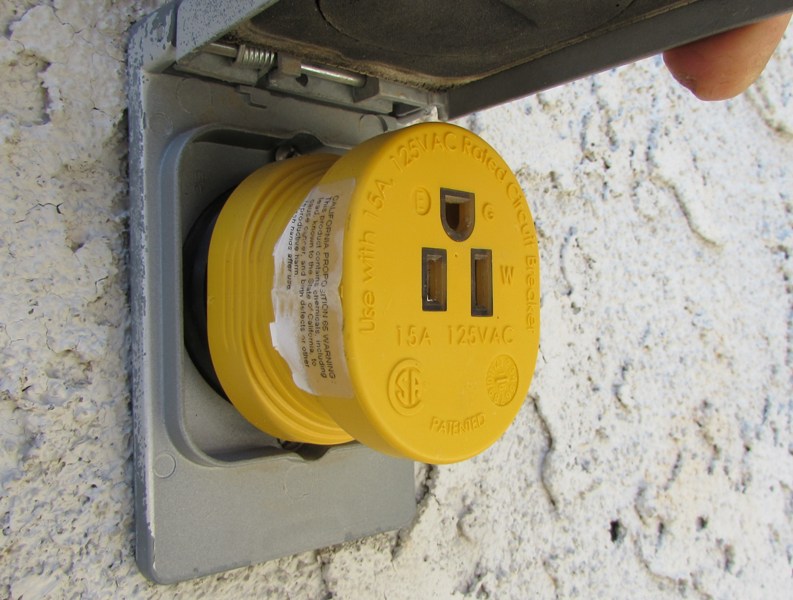

Anyhow, I wanted to use this 110 VAC plug on the side of the house (shown in the top picture) for powering 110VAC tools and was able to purchase the adapter in the bottom picture that allows standard 15/20 amp extensions cords to be plugged in.
Now with that adapter, I can plug in any extension cord.. could be 16 gauge. Well.. if I had a short at the end of that 16 gauge extension cord, it still goes back to a 30 amp fuse (or likely 40 amp). That is well past the current that extension cord is rated for and its possible the extension cord would catch fire.
So with everything you can purchase being so idiot proof now.. I was surprised that I was able to buy this adapter.. But Lowes had it.. I looked for a UL sticker on the adapter.. not to be found.. You can see some yellow letters molded into the part that says something like you should use this with a 15 amp breaker.. which I guess covers their axx for liability.

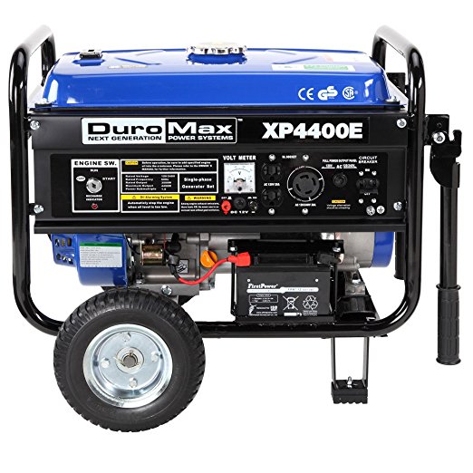

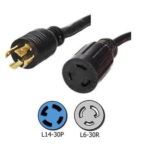

This is the adapter that I use on my new generator purchased from Amazon.
NEMA L14-30P to L6-30R Plug Adapter - 1 Foot, 30A/250V, 10 AWG - Iron Box # IBX-4489-01
Works well with my generator. Very similar to the Predator.
DuroMax XP4400E 4,400 Watt 7.0 HP OHV 4-Cycle Gas Powered Portable Generator With Wheel Kit And Electric Start
That is exactly what I was hoping to do. Run the generator and hook up the boat shore power cord so I could charge the boat batts and use a few small 110 volt electrical tools (shop vac, polisher, etc.) while the boat is on the hard and there is no AC power at the marina.
Thanks for this. Exactly what I was looking for.
