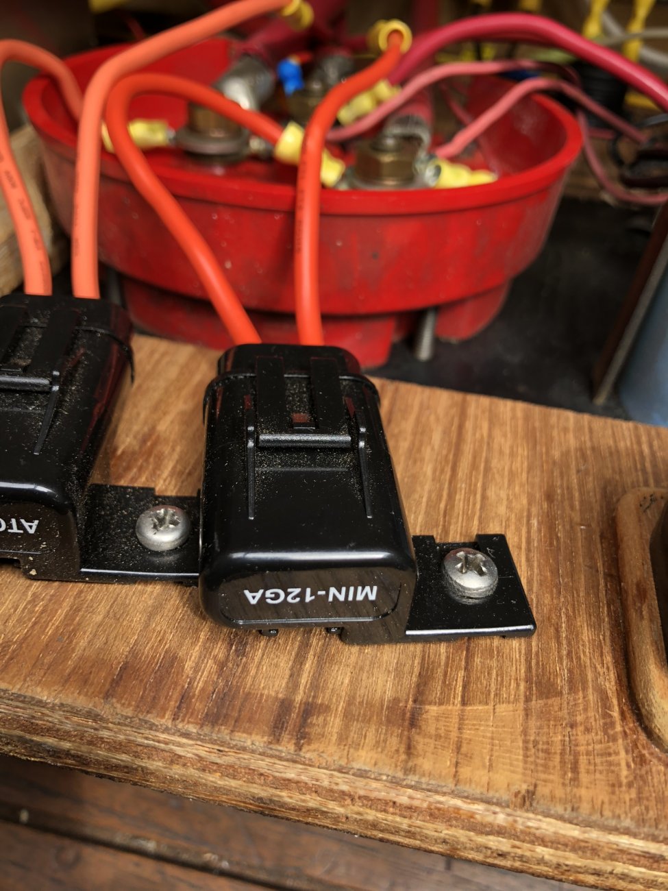

One is marked ATO-12GA and the other is marked MIN-12GA. They’re connected to the battery selector switch. I can find no other markings on them.
It looks like we are looking at the back side of a battery switch.... batteries require a fuse within 7” of the battery between the battery and the switch or any other directly wired device, I think....Where do the wires go after the fuse? Looks like some sort of accessory a PO added to be either powered or to back feed power to the batteries. Their labeling is cryptic, but may become obvious after following the wires.
