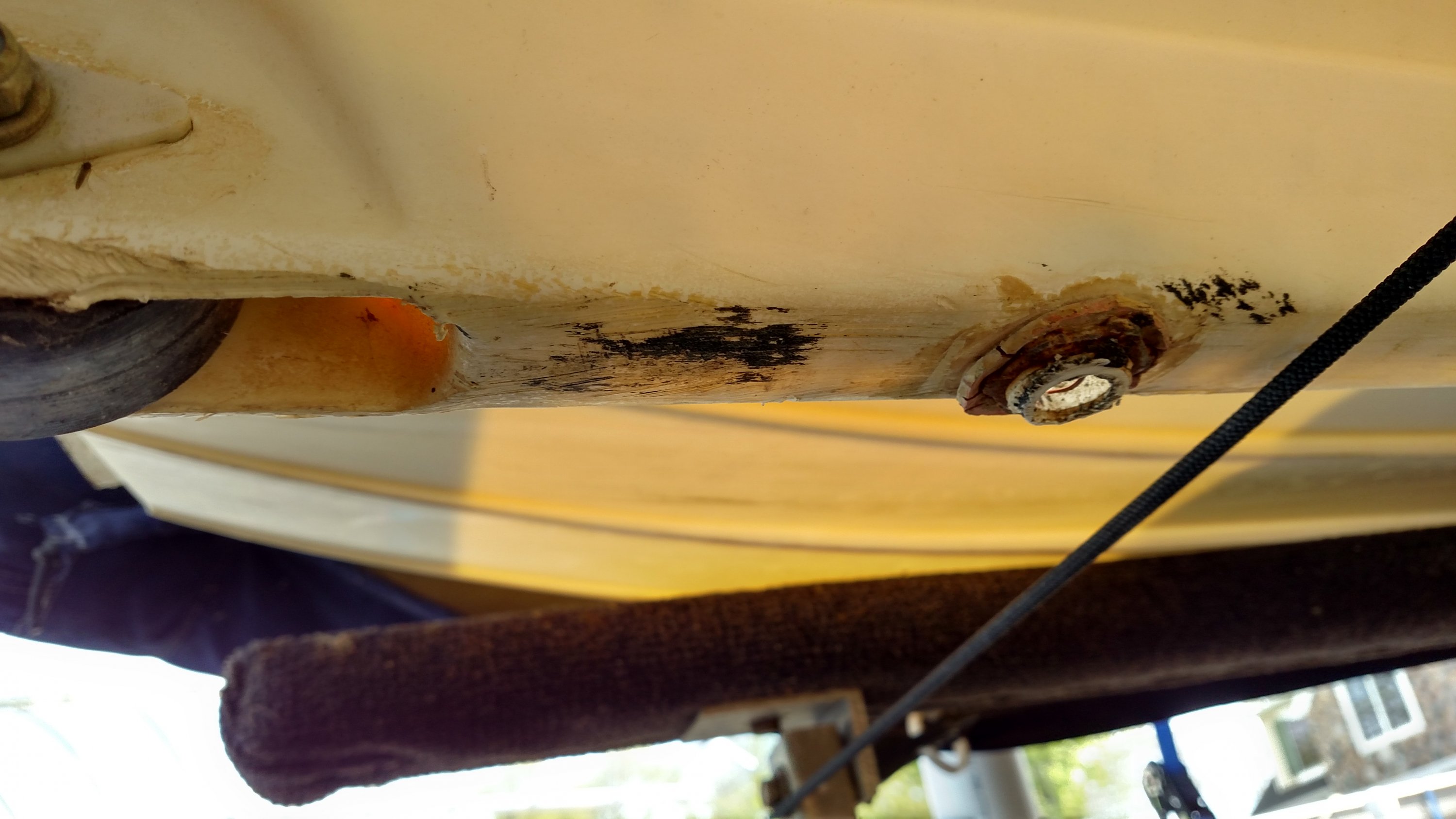

I too am looking to add a drain plug to my polypropylene dinghy. However with the rear bench (see below) I will need to put a pipe through the foam flotation all the way to the transom. I should also run a pipe under the center bench to drain the bow section. I was going to just use PVC pipe, but was wondering how to bond PVC to polypropylene?

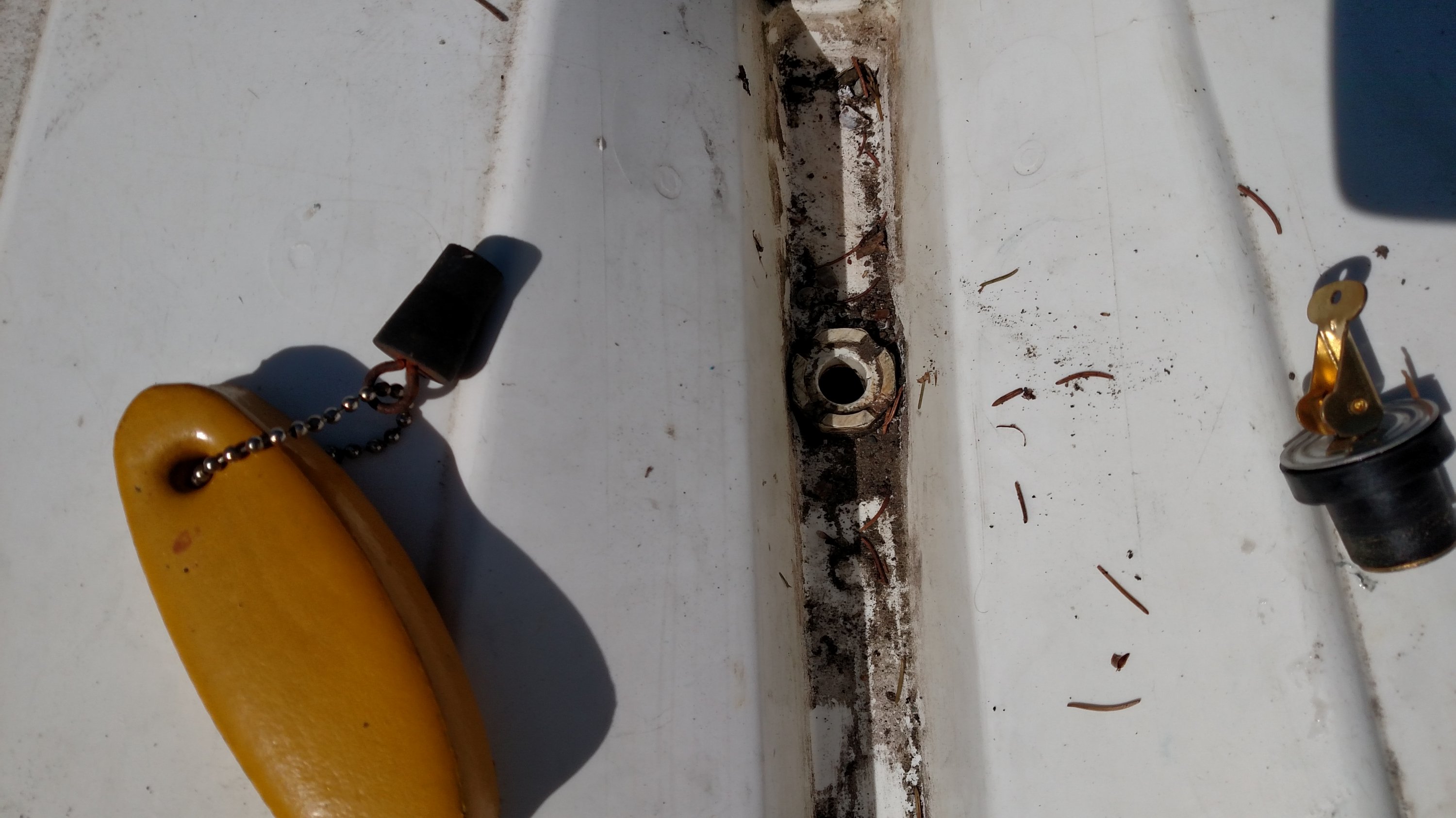

Here is the photo of a 1/2 thru hull located about 6in prior to the wheel in the floorcork and plug.jpg drain.jpg . Also of a cork or baitwell plug that can be used.
