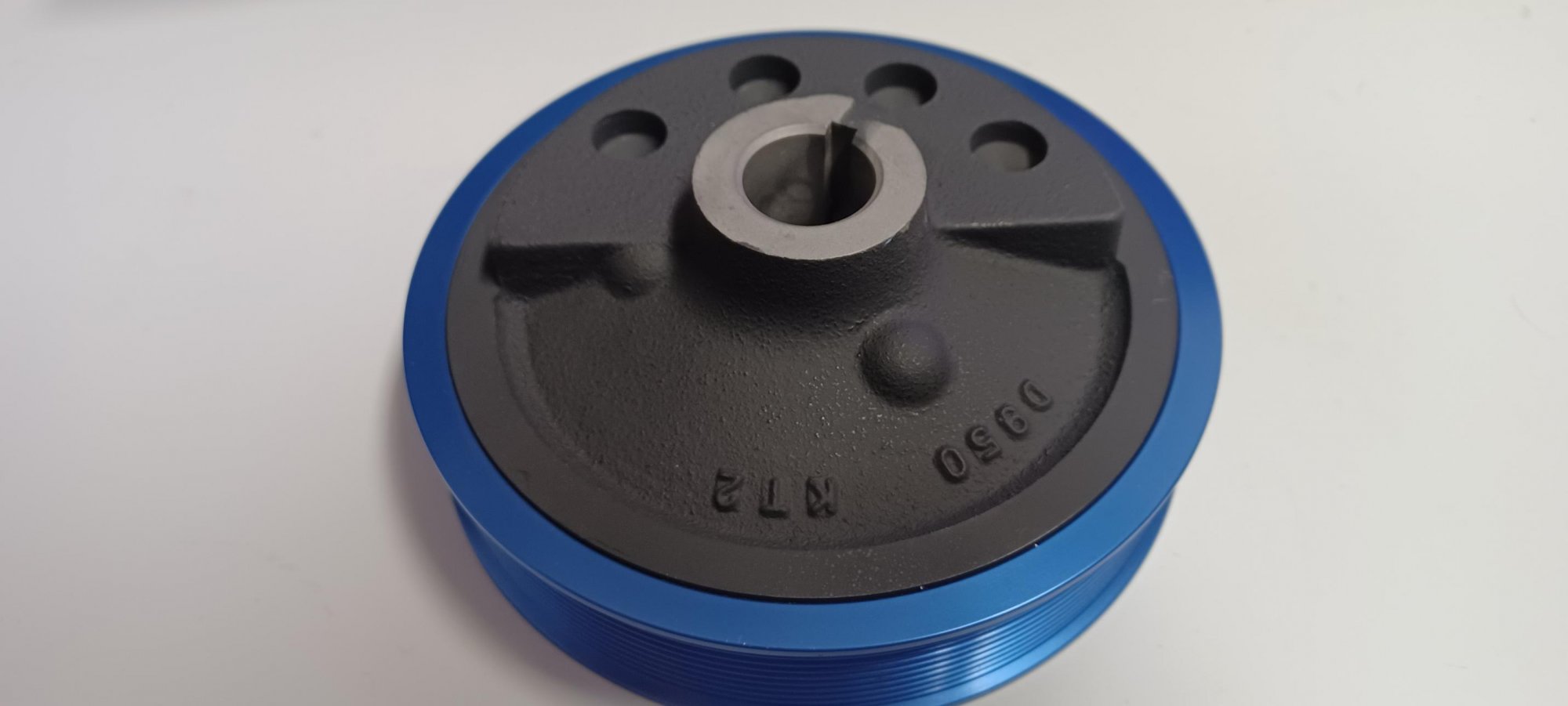

I am installing a Balmar Serpentine belt kit on my Universal M25XP and the drive pulley on the crankshaft does not fit. It is stamped with the part number 48-AM-306. I am hoping to find someone who has one installed that can tell me if they just supplied the wrong part.
The pulley that I have is too small by 60-thousants. :yikes::banghead::banghead::banghead:

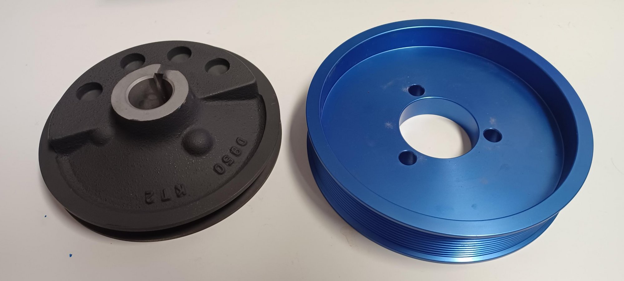

Too small in the ID?
Yep. It should be a close fit over the factory pulley and bolted to the three puller holes but no way it will go on. To make this work, I would either need to have a machine shop machine the overlay pulley ID bigger or the factory pulley smaller. Both will not be cheap and very frustrating given that the thing cost $450.

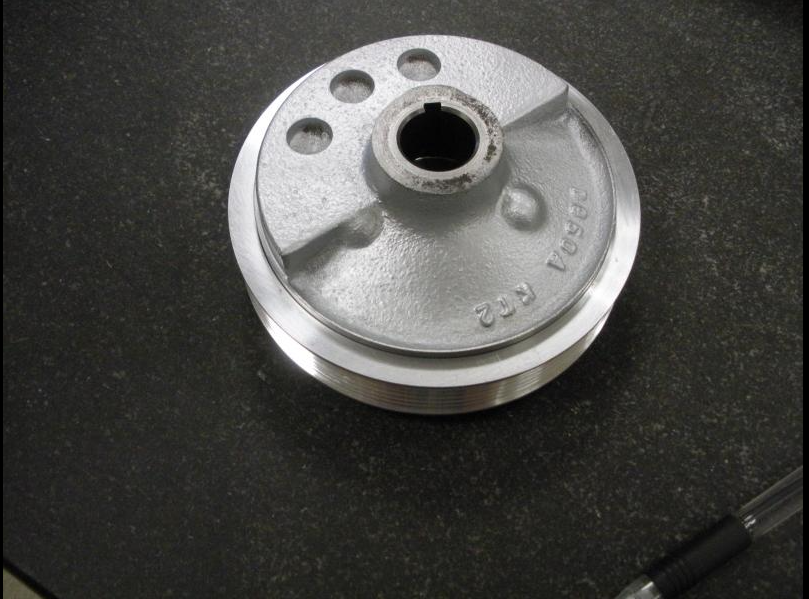

Have you spoken with Balmar? maybe they can exchange it. I installed their kit on my Beneteau and it fit. I made my own kit of pulleys on my C30, same engine. I ended up machining the crankshaft (not easy to remove). I would machine the aluminum pull but it will remove the blue anodize.

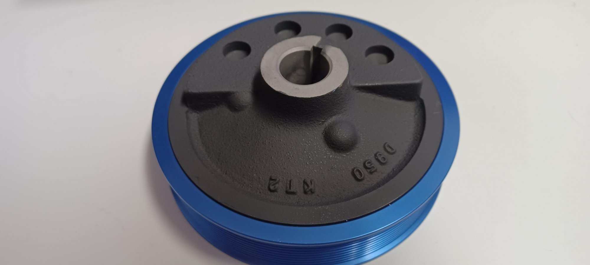

Thanks for the link. If Balmar does not have the correct size of adapter, I will end up doing what you did and remove the balance wheel and have it machined down to match the Balmar adapters. It is not just the blue anodizing which would not show because it would be the mating surface. The bigger challenge is that there is very little meat in the land, and I would be worried about it being too thin after it was turned and then I would be totally screwed.
You mentioned that you had all of the dimensions in a notebook. You wouldn't happen to have the original OD of the factory pulley grooves, would you? I am pirating your photo of the back of the balance wheel to illustrate why Balmar cannot supply an entirely new wheel.
@jssailem here is a photo of the back side of the balance wheel I pulled from @Bob S post. There is a lot of stuff going on at the back side. It looks like on these Kubota engines; it is not a dynamic dampener which is unfortunate. They have an inner and outer metal parts which are separated by a rubber bushing which allows a tiny bit of movement to smooth out the harmonics. It would be very beneficial for a 3-cylinder. This one is just a balancer to correct for imbalance in the crank.

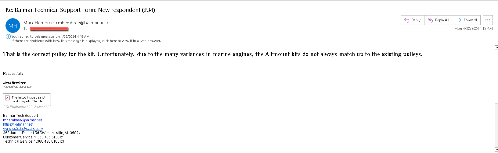

I got Balmar's response this morning. "That is what we consider to be the correct part so it sucks to be you."
Unbelievable. Never buy from Balmar. Their stuff is overpriced, and they do not stand behind their obvious screwups.

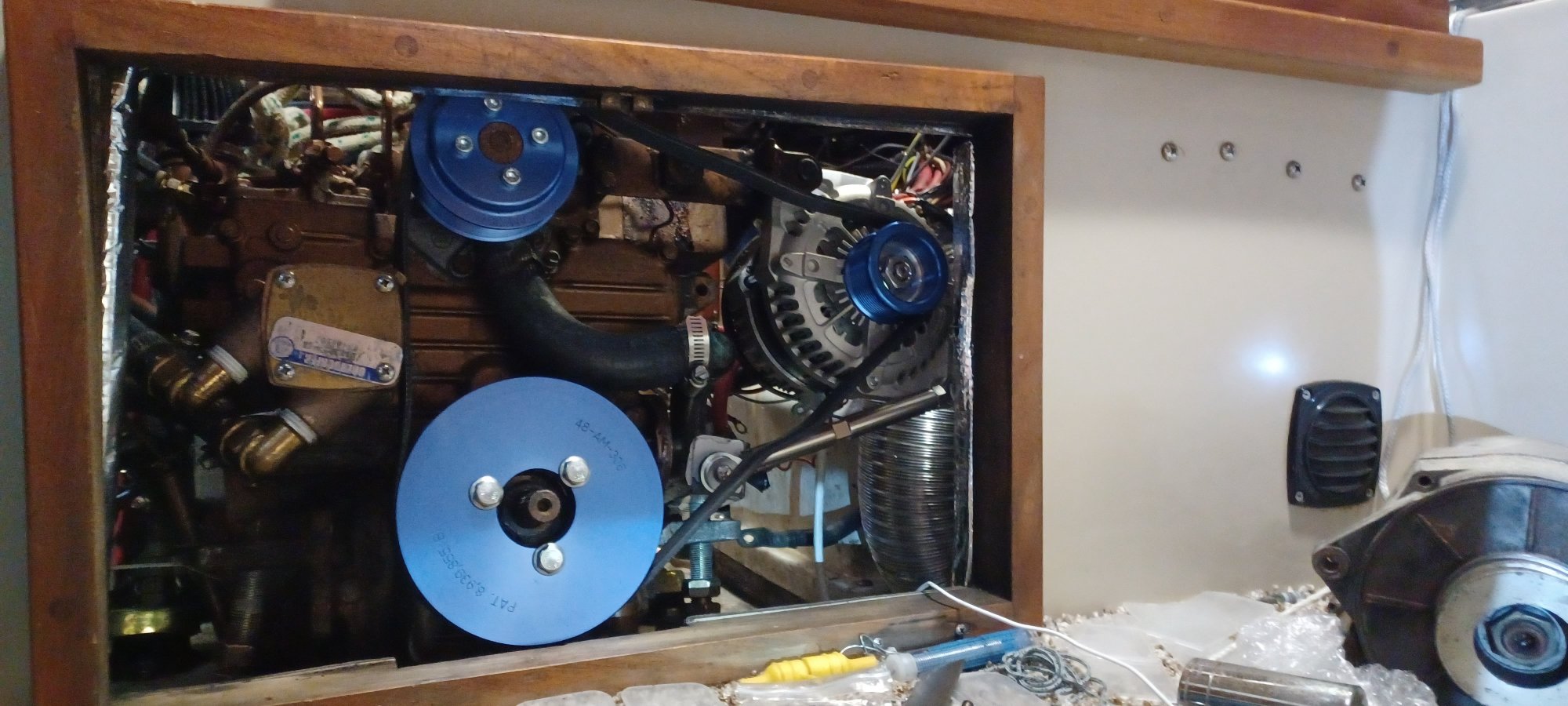

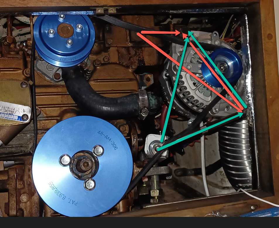

Well I was able to have my balancer turned down to fit the balmar pulley for the low, low price of only $137 :banghead:
It turned out great although I sure wish I had gotten the MSE kit which would have been bolt-on.

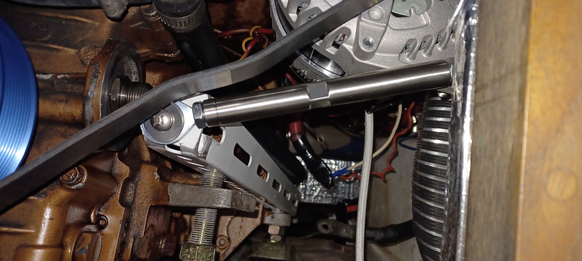

Here is how it looks after putting everything on the boat.

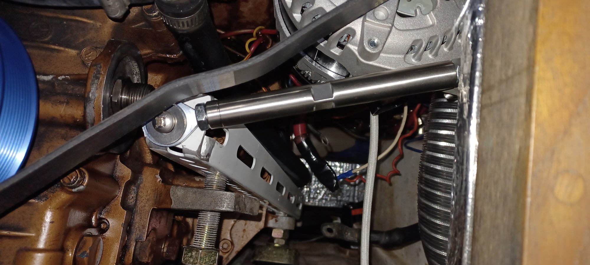

I was concerned about the original support arm. In addition to being very thin, the angle between the line through the two alternator bolts and the two bolts on the mount is more than 140º and per my geometry textbook, that angle is every obtuse [angle greater than 90º] and so is whoever was stupid enough to think that was a good design! Per the Websters dictionary Obtuse: lacking sharpness or quickness of sensibility or intellect: INSENSITIVE, STUPID) (See red arrows in attach photo) The very short distance on the alternator bracket between the pivot bolt and the anchor for the adjusting arm, greatly increases the loads on the bracket. I have heard of several of the new style brackets breaking and the engineer in me suspects that this is the root cause so given that I am looking to get about double the power out of my alternator than I ever have, it is time for an upgrade.
My new large frame alternator is about 1/2" larger diameter than the old small frame so I must replace the adjuster. What I am doing, it is fabricating a new support structure that attaches to the top side of the motor mount flanges and projects forward to 3/4" behind the belt. To this, I am attaching a Hiem link that will attach to the adjustment anchor on the alternator at 90º and there is nothing obtuse about that! In fact, not it is acute! Now the pivot support arm triangle is pretty close to an equilateral triangle which will put equal force on all three lines and will reduce the load on the bracket to less than 40% of what it was before.
