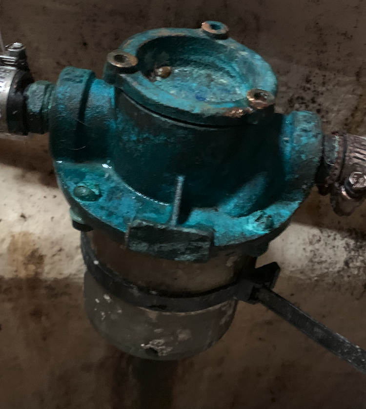

Anyone identify this raw water strainer?
edguy3
Jul 20, 2009
38
Hunter 40.5 Liberty Landing, NJ
I have a '95 hunter 40.5 and need a new sea water strainer basket for the AC. Can anyone identify this model? Cant find any markings other than "in" and "Out"...
thanks in advance
/ed

Thanks! - I saw that brand on line and saw some similarities; I'll try their customer service.

Yes. Looks like an older groco. New ones (750 series) are bronze, glass and plastic with O ring sealed tops the unscrew easily providing access to cleaning out basket. I like my install.

I installed these in my 40.5 for my aux, genset, and A/C. They are Groco strainers. The info on them is:
The model number of the strainers is according to the threaded inlet & outlet. ARG-750 for 3/4" threads, and ARG-1000 for 1" threads.
Stainless steel strainer baskets are also available for a premium price. Your choice. The original baskets were S/S but I have replaced with plastic. They work just fine.

For future reference, here's my dialog with Groco Support.
( Grade A in my book )
>>> To info@groco.net
Hello, I was hoping you could help me identify the product in the picture below and in particular which replacement
basket it uses. It is in a 1995 hunter 40.5 and the basket measure about 1.75” in diameter and 5” tall.
It resembles your current product line and others have identified as a Groco as well.
Thank you in advance.
Ed
<<< From info@groco.net
Hi Ed, it is best to figure out which ARG strainer that you have by checking it against the dimensions that I have here in this link: Raw Water Strainer | GROCO
>>> To info@groco.net
Thank you.
ARG-755 is the closest match – A=6.5 B=4-5/8 with ¾” threads. I can’t get a good reading on the “C” dimension while it is installed.
So, I’m coming in about 0.1 over.
This would give me a BP-1, BS-1 or BM-1 basket, which seems a little larger in diameter than my current model. 1.9” spec vs 1-3/4” measured.
The height looks fine.
Sound right?
Thanks again
/ed
That should be correct since 1.9 is the smallest size that we go down to.
