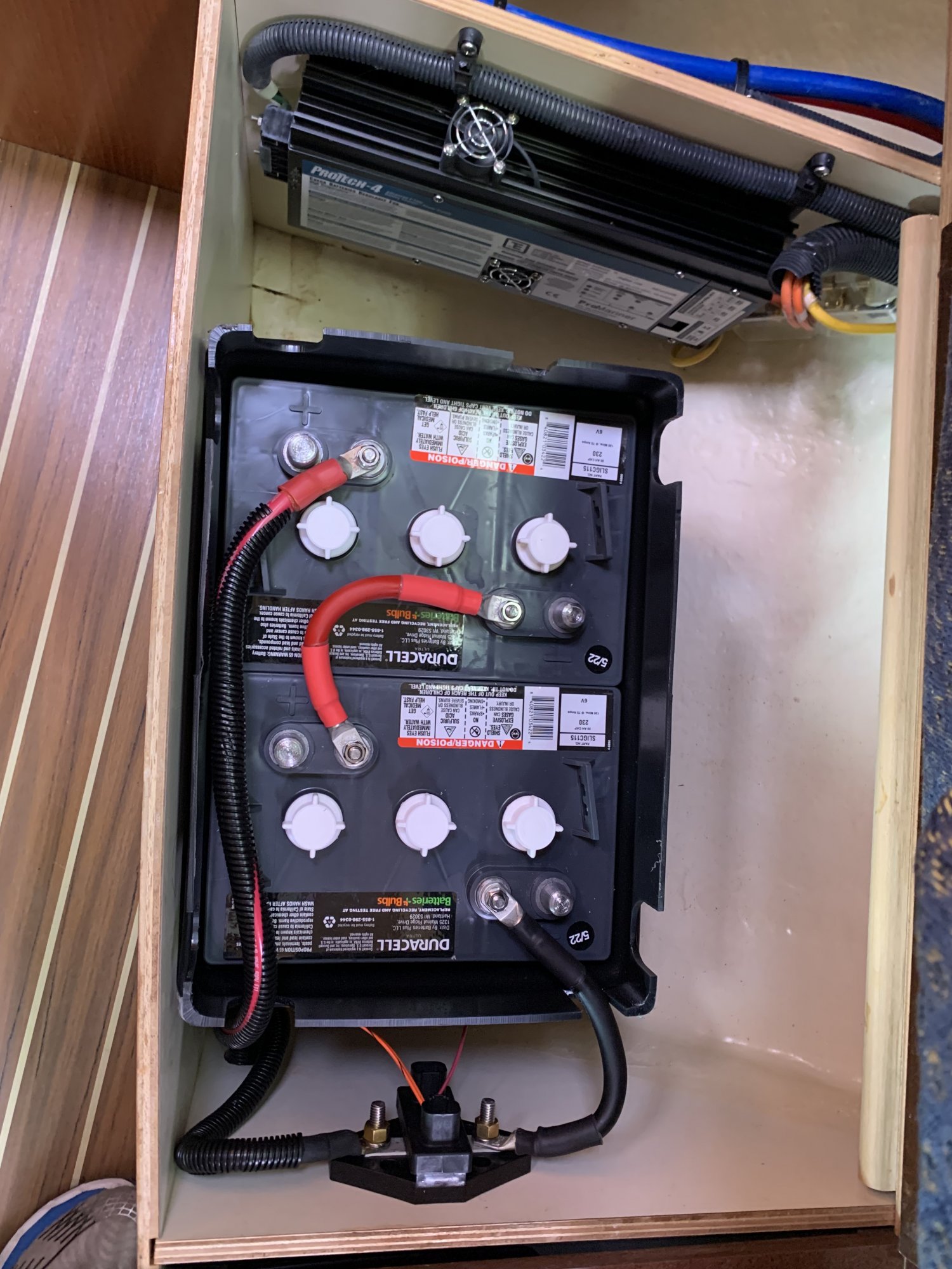

Thanks JD. Our boat came with a group 24 deep cycle for the starter (in the aft starbd. settee) and a group 27 for the house bank (in the forward starbd. settee). The “house“ battery was never really big enough, and I didn’t have a battery monitor, which contributed to my killing a brand new battery in 2020 on a trip in which I was able to sail multiple days in a row with little engine use.
So this past May, I replaced the gp. 27 with a pair of 230 Ah 6 volt batteries. They both fit in the forward stbd settee, oriented side to side, which is supposed to be better.
At the same time, I put in a Balmar SG200 monitor. You can see the shunt in the picture above. This was really not a hard project, although it did take a lot of planning and reading. It was waaay easier than the fridge install.
I did consider putting them on the port side, but I was too lazy. We also put food over there, and I didn’t want a battery and its fumes in the same compartment with the food. I kept the ice box as an ice box, which is needed for multiple days and 4 people, for example.

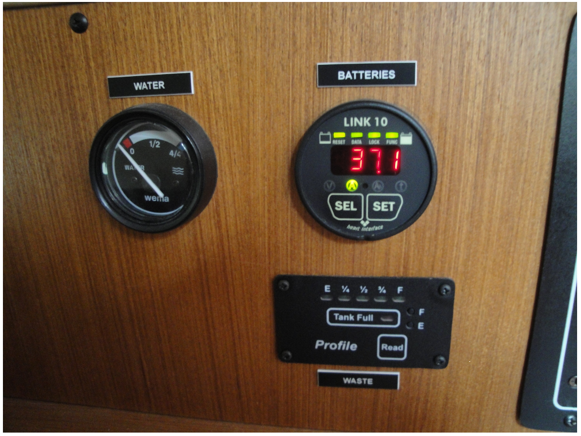

I strongly recommend a battery monitor, which I had been lusting after for many years. Without one, you're just killing batteries and guessing about your true electric draw. With a monitor, you can turn on just the anchor light (e.g.), and see how much it really draws.
I saw 1.0A with tungsten and 0.1A with LED. That's about 6 amp hrs. for tungsten and 0.6 amp hrs. for LED each night at anchor. Well worth it for the savings in battery amp hours . Everything in the boat is now LED.
Beautiful! I'm officially jealous.
