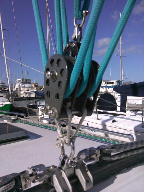

Over the last several years, for various reasons, I've sometimes opted to attach rigging hardware with Amsteel instead of normal stainless steel "U" or "horseshoe" type shackles.
Is anyone else doing this? For what applications?
My most recent Amsteel "soft shackle" application is in the attached picture. I cobbled together unused Harken big boat low friction cheek blocks (ball bearing + roller bearing sheaves) into a triple block for my main sheet at the traveler. The 1/4" Amsteel is rated at 8600 lbs breaking strength. Should be amply strong. Plus likely even greater since the load is shared among the four turns between the "block" and the traveler. No metal shackle would have worked here. The Amsteel was the solution in this case.
