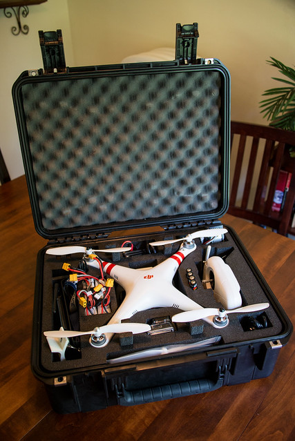

That's cool. That's very cheap. I guess it depends on the intended usage. I wanted 1080p minimum video (I usually shoot at 2.7/60 so that I can use Warp Stabilizer in Premiere without loosing any 1080p fidelity) on a gimbal. The best quality quad video I've seen is from GoPro's or EVIL/DSLR rigs on gimbals. So I setup for a GoPro solution. The Phantom was $600, the GoPro was $500, the gimbal was $600 which included a new PMU, the 5.8ghz video transmitter was $100, the iOSD telemetry module was $200, I replaced the main board with an upgraded board, that was another $150, A good water tight case for everything $200, 7" LCD screen+battery+mount was $300, replaced several props (usually after a crash)... $100ish, several LiPo batteries so far ~$150-200, a better charger to charge all the batteries $100. I'm sure I'm forgetting a few things, been improving it over the past year and a half as I figure out what limitations I want to overcome. I'm pretty happy with the video quality now finally, when I first got it, the video was pretty terrible, lots of jitteriness and short flight times.

Nice upgrades and great case.
Guess it is just personal but if I can build it I typically prefer that approach versus a off the shelf option.
Once I am more comfortable with techniques and filming then I will build a nicer rig like yours. Still custom but I know I will go with the Vector flight controller for the integrated OSD and RTH features. If I had that much in camera gear I wouldn't trust it on a quad so that is why the hex or x-8 would be the next build.
