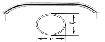

Helped a friend bring his 49' Beneteau home to Quantico this past weekend, Noticed on his dodger really nice handrails (looks like something PaulJ would dream up). So I looked online and found these and am wondering if PaulJ or someone else has done this.
http://www.bosunsupplies.com/products2.cfm?product=L7781

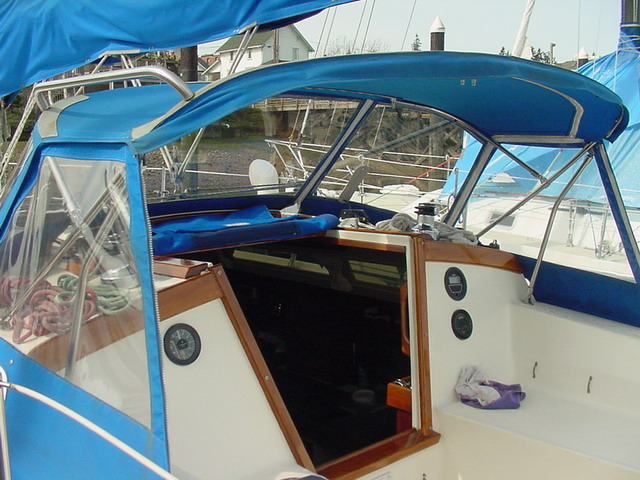

Catalina 36 Gig Harbor
Have some on a C36 and really like them.
Had a canvas guy install, since I'm not good at drilling stainless tubing.
Very handy for helping my wife come aboard and for going forward.
Not quite as elegant as the welded-on variety, but these can be removed and reinstalled when it comes time to replace the dodger fabric, rather than have the canvas maker work openings around the permanent kind. Was told that the heat of the drill would seal the Sunbrella. Have not noticed any drips from the acorn nuts while washing the dodger or during heavy rain.
Good luck

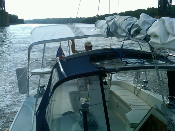

Catalina 310 Solomons Island, MD
Here is how mine is set-up. The boat came to me this way, seems pretty well thought out. The canvas is removeable without having to take apart any of the frame. Don't think I would clip my harness to them but they are sturdy enough that I use them whenever I go forward.
Sep 29, 2008
1,981
Catalina 310 #185 Quantico
Silvio those are nice
Like that they put them in the gap above the windows. I like that.
