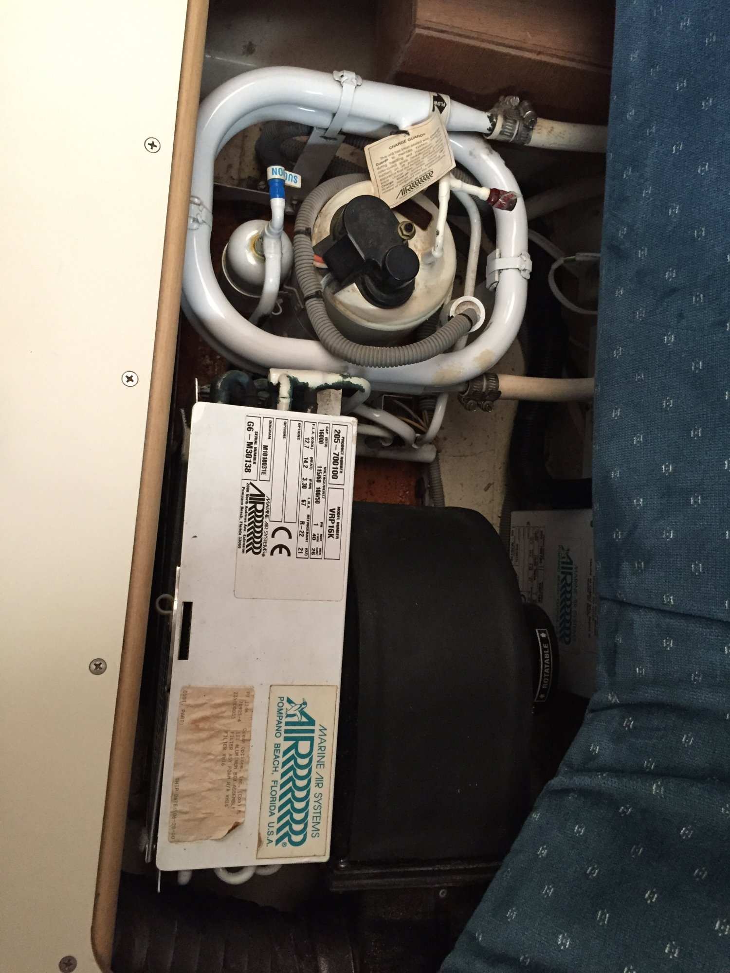

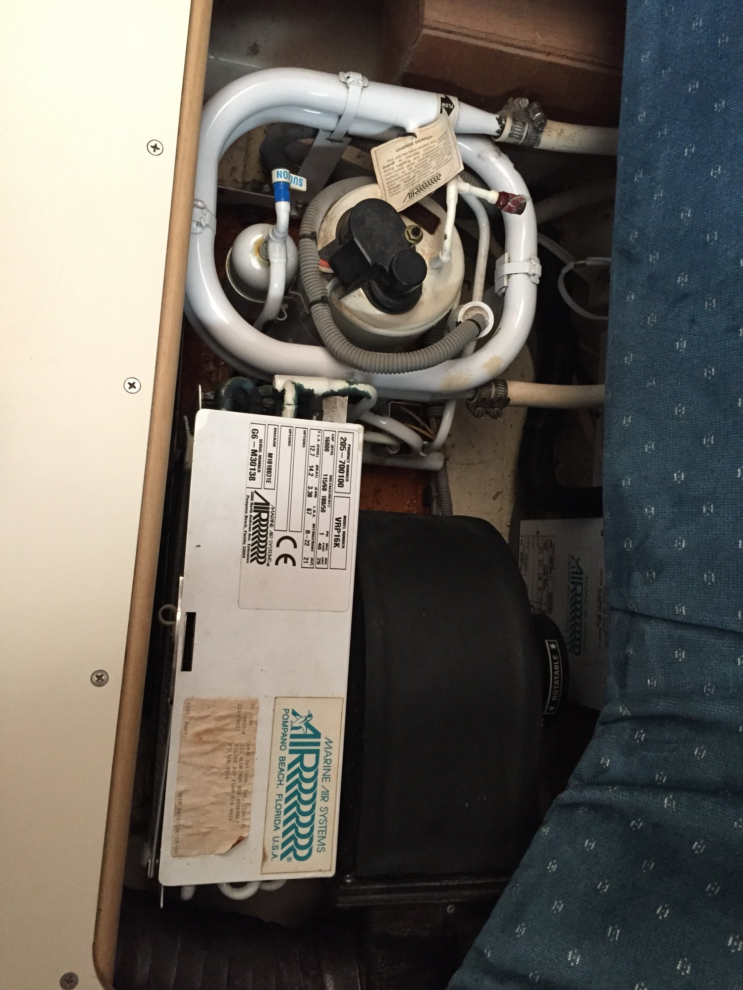

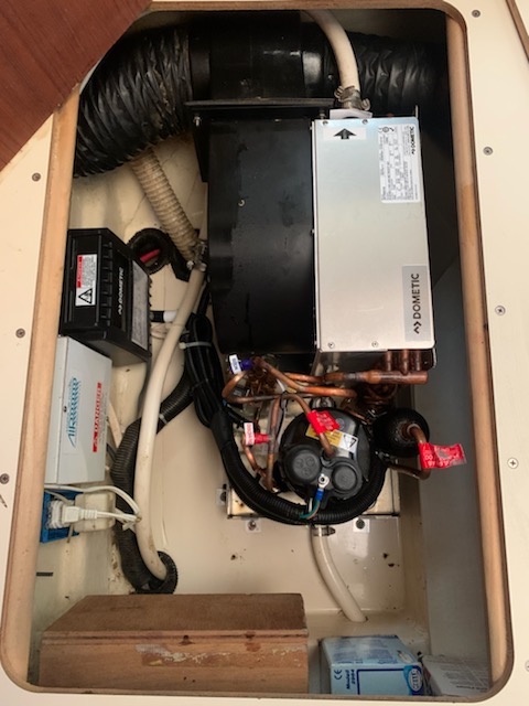

How has this been dealt with a replacement and if so, how did you deal with the ducts?
Easier than I thought.
Old one...
New Unit is quieter and more compact.

PS: MarineAirr has always been owned and made by same company who broaden its scope under the new Dometic name.
PSS: The Top picture should be rotated 180° to match the 2nd picture orientation.
