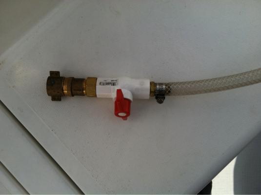

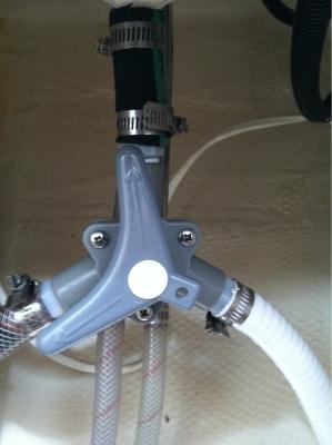

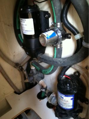

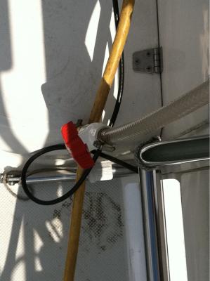

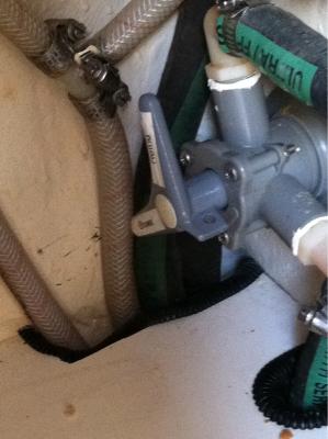

Here are some pics of the system.
1. Y-valve for fresh water flush and head sink drain.
2. City water connection. Always stays out of boat when using. Haven't used it yet.
3. City water connection.
4. Fresh water "control center".
5. Y-valve to use shower sump to drain shower or fridge.
