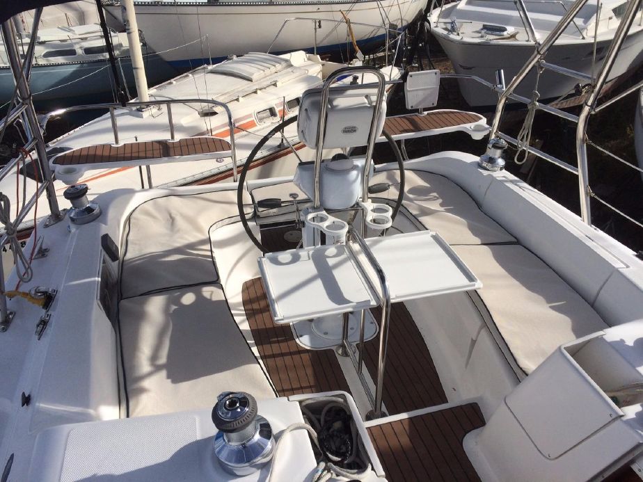

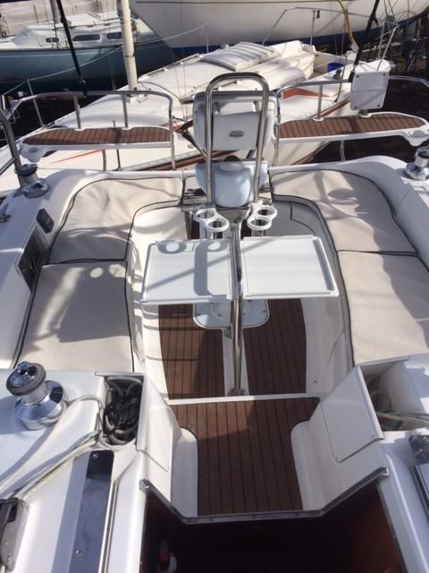

Hello all,
We are looking at a 2006 Hunter 38 and are wondering how we could enlarge the cockpit table as it is quite small (not even wide enough to accommodate two dinner plates on each side). We currently own a 356 and the table is wider than on the 38. We can comfortably seat 4 people for dinner in our cockpit on our 356 and would like to be able to do the same on the 38.
We noticed one picture of an enlarged table in the "Modifications" section but no details of how it was built.
Any suggestions would be much appreciated. Thanks.

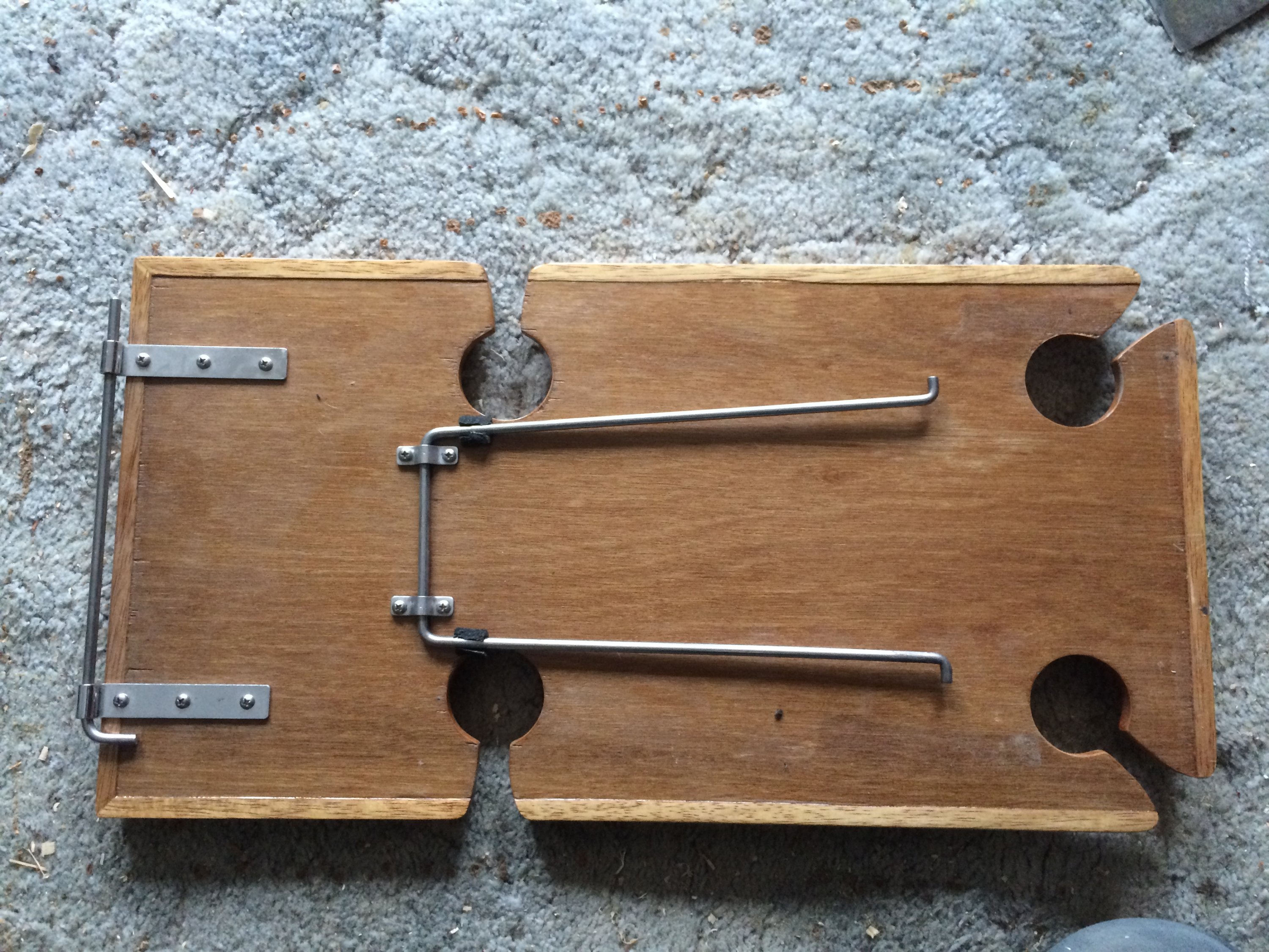

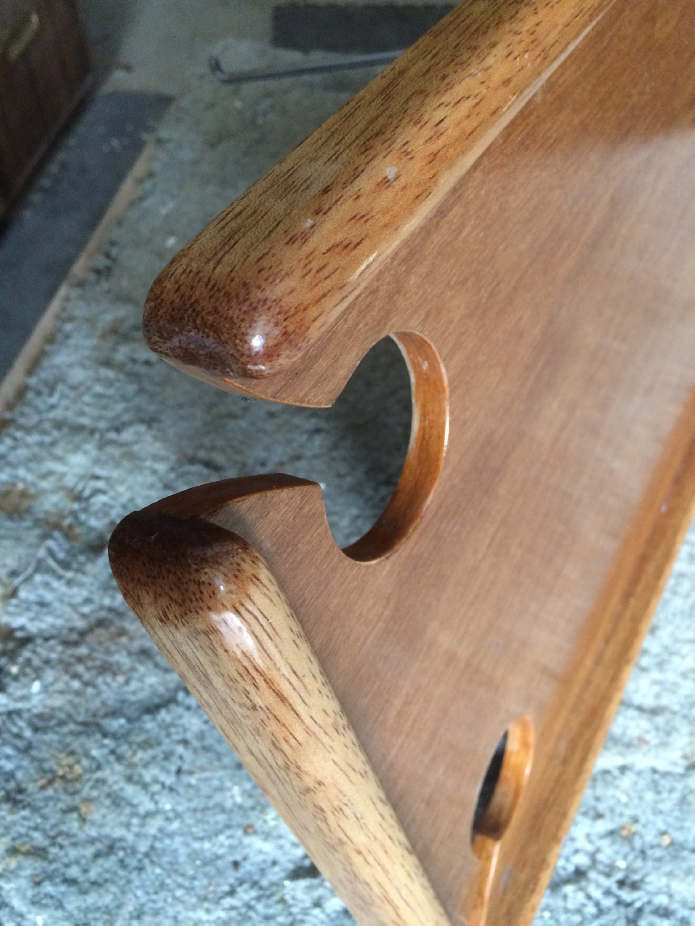

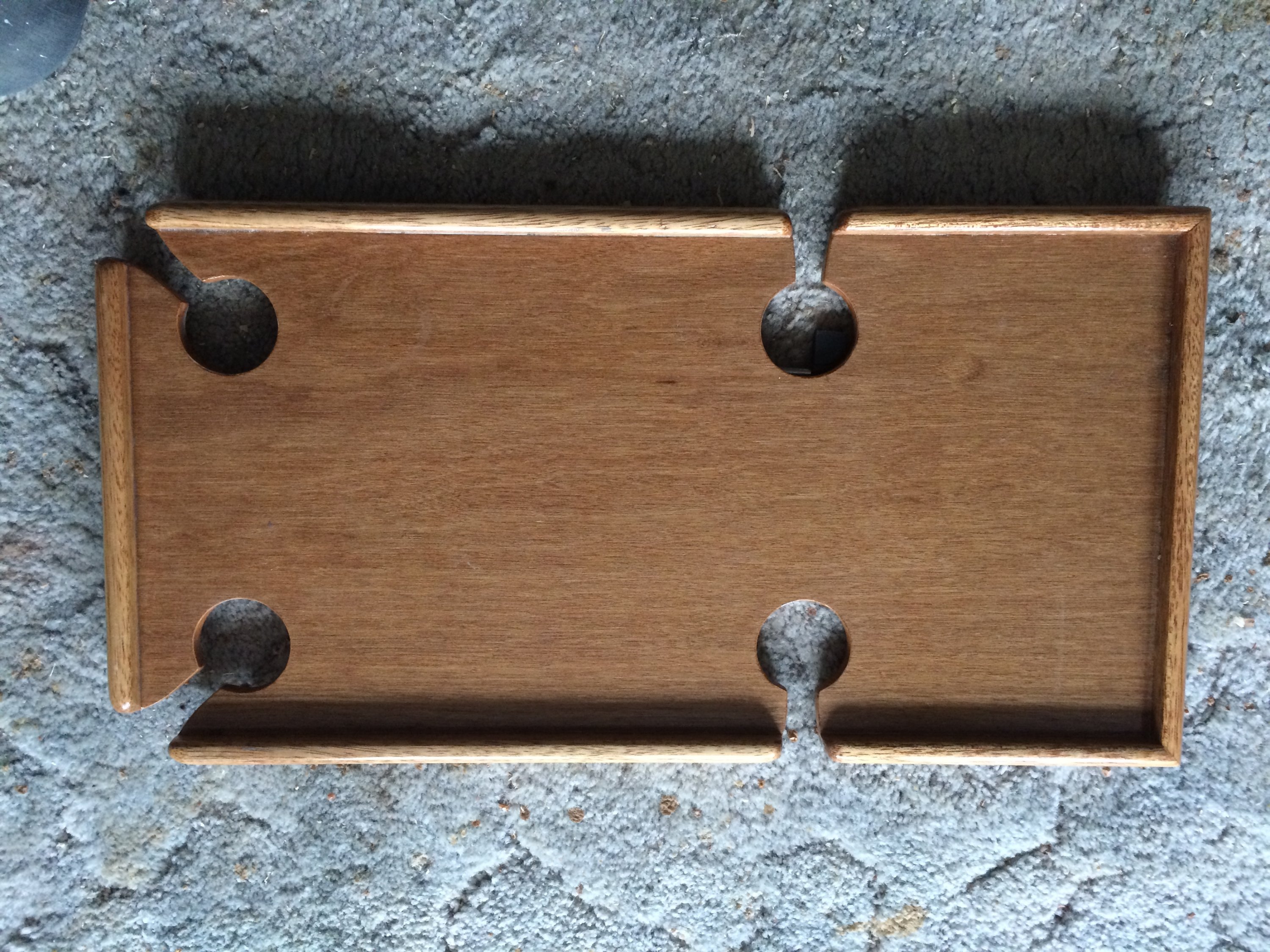

Finefurn...I'm wondering if you could include some pictures of your table?
Welcome to the forum . I'll get down to the shop later this week and take a few pics of the table top. I did increase the length a bit from the original and added cup holder cutouts. At some point this year I'm going to add some drop leafs as Peggy Hall suggested. One thing about owning a sailboat is that, You will never again be able to honestly say "I have nothing to do"
Oct 30, 2011
91
Hunter Cherubini 27 Mason
Cockpit table 4.JPG Cockpit table 1.JPG Cockpit tab;e 2.JPG These are some pics of the cockpit table I built for my H27, I increased the size slightly to 13"w x 25"L and added 4 cutouts for drink holders. If I were to do it again I would increase the width approx. 15"
