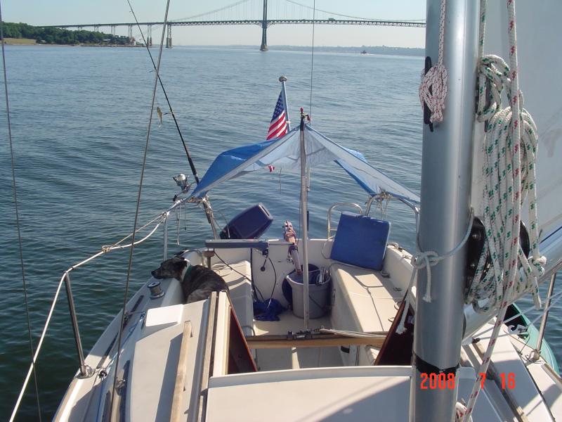

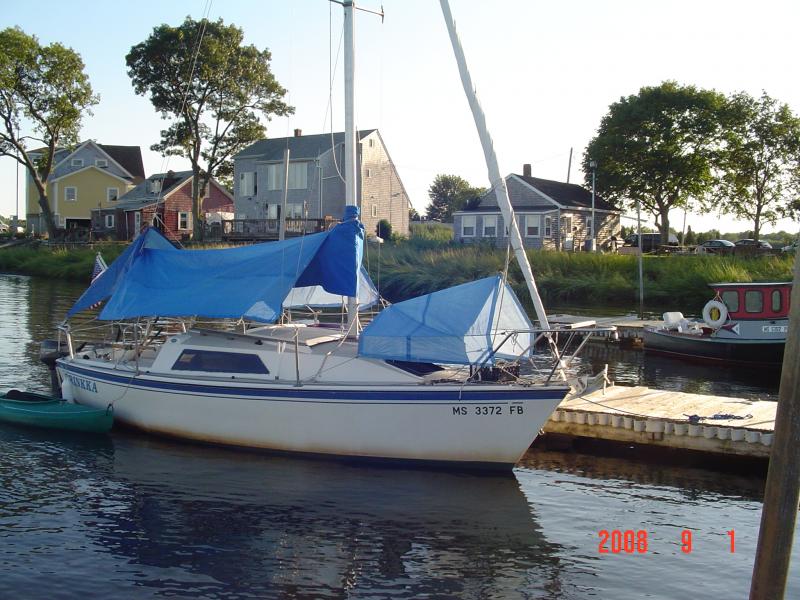

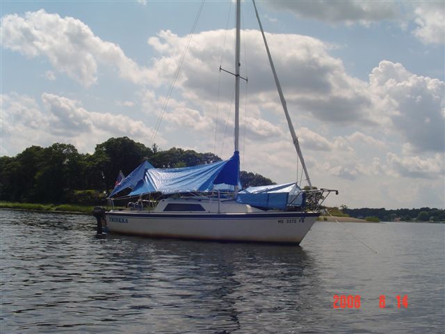

I don't think that opening ports are going to do it for you. You could leave that forward hatch wide open on long tacks but at some point you'll need to keep messing with it when you come about. Also, there will be times when you'll need to keep it closed when the seas get a little rough and spray starts entering your V birth section.
On extremely hot days I usually find a nice cove to anchor in and set up my polytarps. I use about three of them of various sizes on my boat.

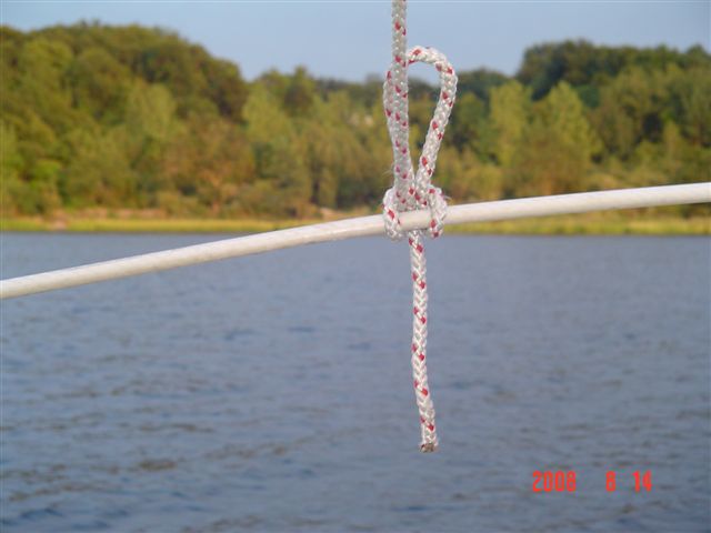

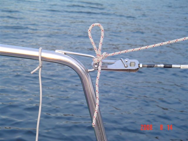

Polytarps are pretty cheap. All you need is some 3/16" nylon braid and a 1/2" brass grommet set for installing the grommets where the tarps can be tied evenly. I use quick release hitches on the ropes of my tarps for fast set up and removal.
I've set up a 5'X7' polytarp to my stern rail and used my boat hook to support it while sailing along on hot days.
My main tarp is an 8'X10' that I tie over the boom.
I have a 1 gallon weed sprayer filled with water and I use it as a cooling mist in the cockpit. I cut the wand down a little shorter.
The way I see it is; it may be hot down in the cabin but the dog and I are sitting out in the cockpit with either a golf umbrella or a small polytarp to keep the sun off us, but when we anchor the other tarps go up and that cabin and cockpit are a lot cooler on a hot summer day.

That's a single round turn with a half hitch done with a byte?
Jan 24, 2005
4,881
Oday 222 Dighton, Ma.
Re: Any suggestions for putting opening windows on a 23 (Or
I think the first one is a slipped clove hitch and the second one is a round turn with a slipped half hitch, Keith.
