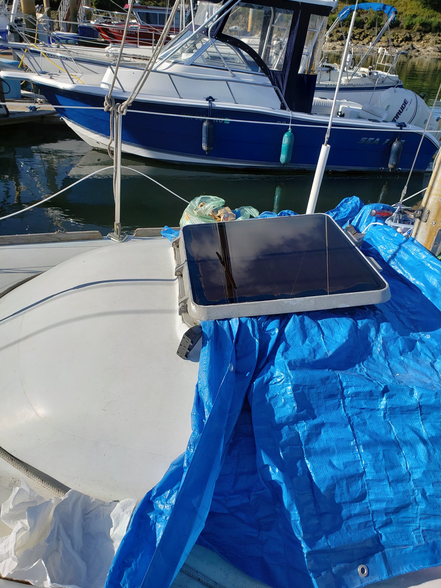

K KGarvey . Jun 5, 2018 48 Beneteau 35S5 Buffalo, NY May 20, 2022 #5 The boat is a 1989 Beneteau 35S5 Dimensions gasket to gasket 15 &1/8" wide 20 &1/4" depth

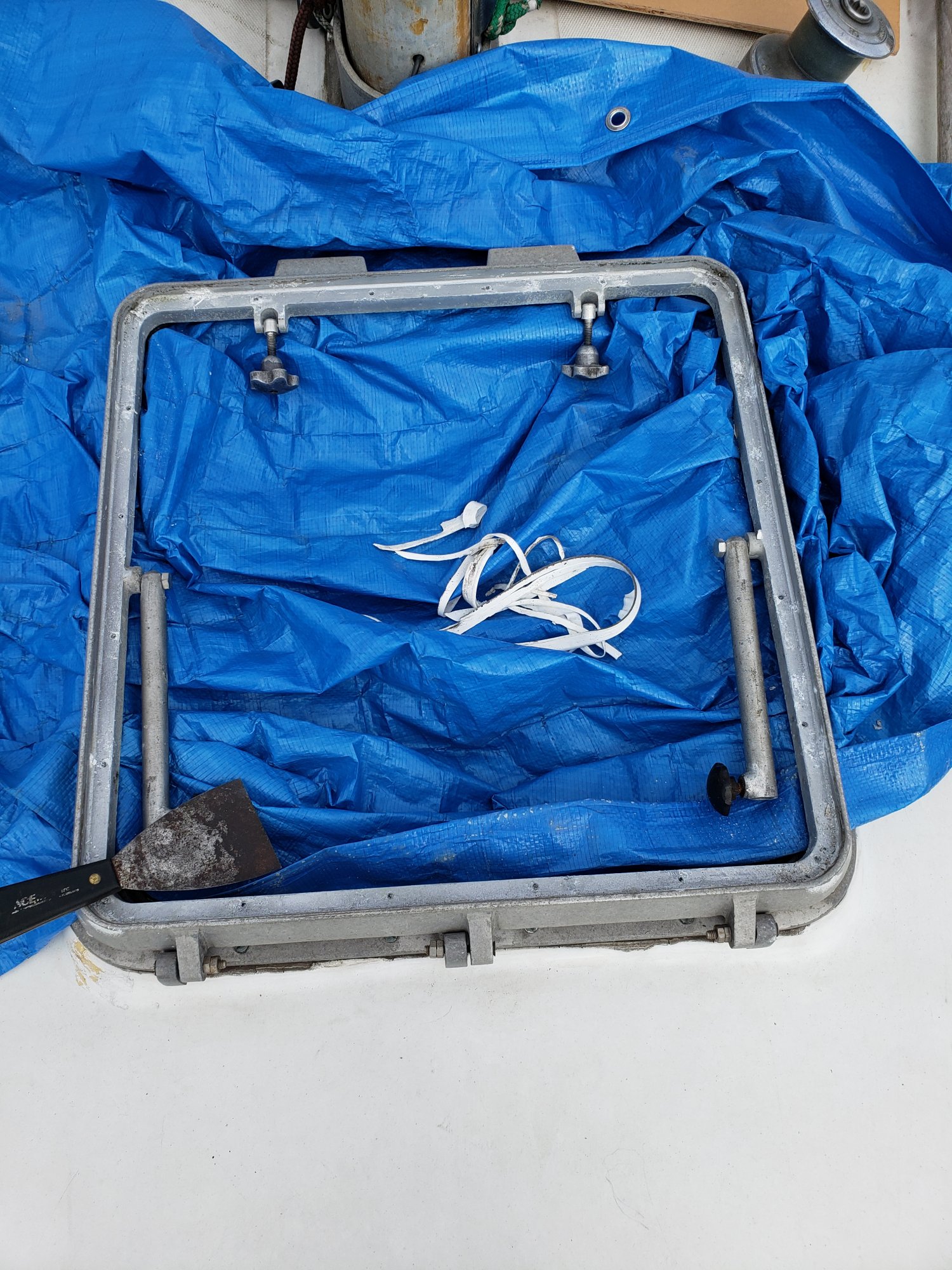

P pipedream . Jul 18, 2015 74 South P10 Pugetopolis May 20, 2022 #6 Just finished mine yesterday. I had the basic measurements cut, then put the radius corners in with a router. Installed with dow 795. Attachments 20220517_163409.jpg 590.6 KB Views: 76 20220519_175506.jpg 547.1 KB Views: 75
