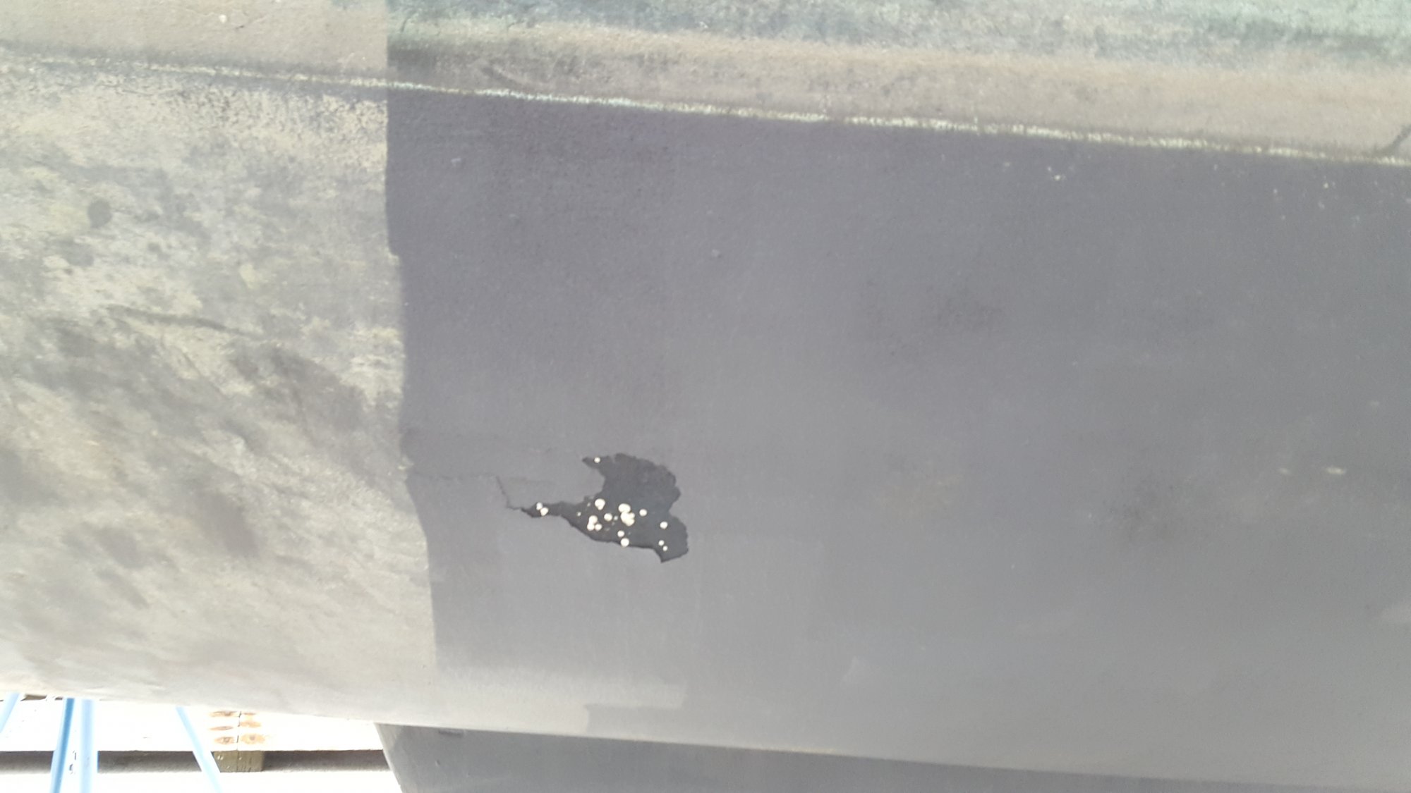

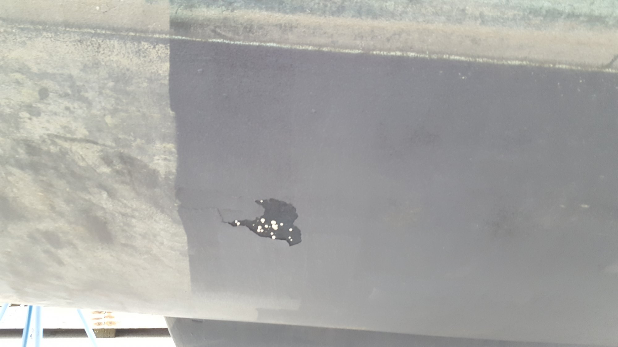

I used Dumond Peel-Away. Did my hull over two seasons. It worked well but was on the expensive side after all was done. It didn't touch the barrier coat. There was an issue with retaining the paste and paper on near horizontal surfaces .
I might consider for a small boat but would not do agian on a bigger boat. It did easily remove 10+ layers of paint.

The paste stripper removed all 10 coats in one application if the paste and paper stayed on the hull. The only sanding was the paint residual. The left side showed the stripped hull and rhe rright was left for another year but you can see the paint flaking away
