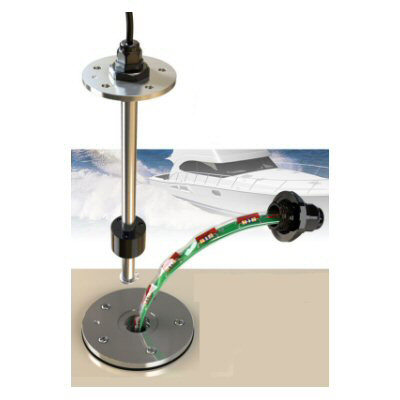

Also searched previous threads and it seems the WEMA sensors might be a bit more stable and was wondering from the forum of any positive or negative experience with these types of slide units:
http://www.wemausa.com/tank-sensors/details_SSS_SSL_tank_sensors.htm
My tank is 16" wide X 24" long X 12" height, so I'm guessing I should use a 11" sensor to allow the one inch on bottom not to be measured since the pick-up tube is a little bit off the bottom of the tank.

We recommend with our Monitor panels the WEMA SSL. Since we don't make one we tested many fuel senders to go with our products and the SSL was better then most.
Stu is also right they all do fail sooner or later but the SSL seems to be a lot better then others.

I'll second Dennis's recommendation on the WEMA sensor. When our sensor failed on the boat I had before this one, I switched over from the arm style to the WEMA. I found it to be a little more accurate.

I have had a WEMA unit for a couple of years. So far so good, no complaints.

WEMA here also. Have had it for about three years. Very high quality. (I hated to hide it in my fuel tank) True, it does have a moving part (float) but I can't see how it would fail. The float isn't physically attached to the sender unit, no wires, contacts etc.
Pretty reasonable cost.
