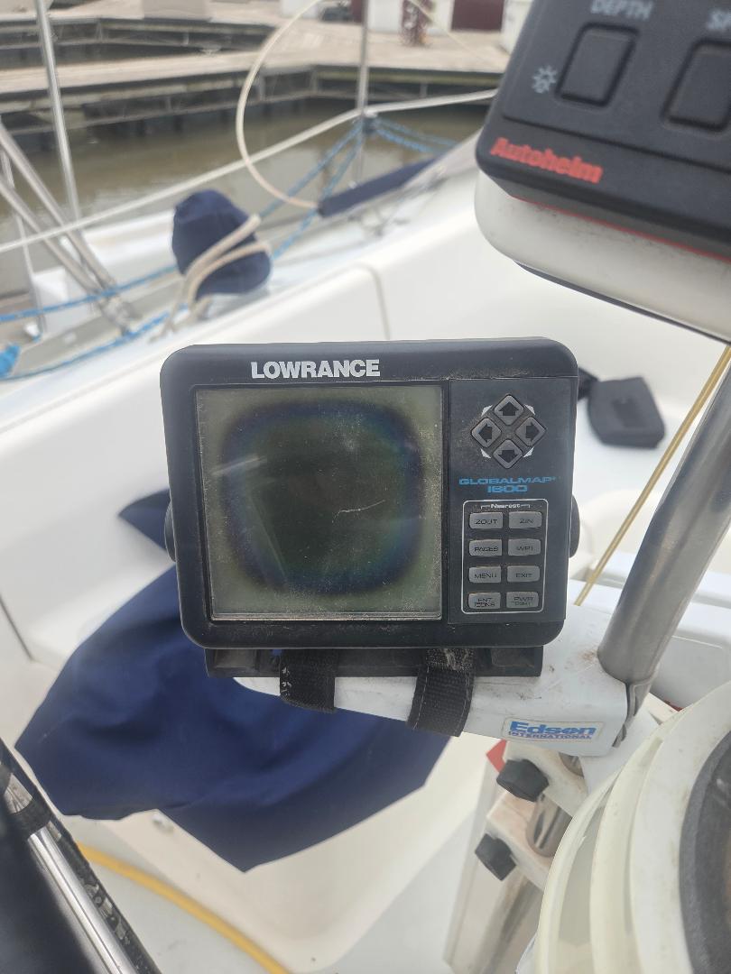

A couple of my displays have gone bad. They still work, but they are hard to read. Is there anyone who repairs them? The Lowrance, I can probably upgrade, but the Raymarine Autohelm would be difficult. i.e. expensive to upgrade. Thanks!

I bought a new screen for ST 4000 AP for $100 on Ebay, the seller also does installations for $50.
Do a search and look for the seller in Durango, Colo.
This is the same guy. I am going to ship the instrument to him and he will replace the screen and check it out. What a relief I don't have to upgrade everything! The Lowrance GPS is a lost cause.

Instrument is boxed and ready to ship tomorrow! Carefully marked where all the wires plug in! Thanks again for the tip!!

I don't know the production era of the subject instrument, but the factory should, at the very least, provide a "help" or "support" service to support their products.
That ST4000+ is at least 26yrs old, and was an existing product from a different company before Raymarine acquired that company. It was discontinued as part of that sale. Raymarine has since been bought and sold several times. The unit is many generations and companies ago, uses components that haven't been in Raymarine's production for at least a decade, so it isn't reasonable to expect any support for it at all.
In today's electronic instrument world, there isn't any fixing to be done at all. With the exception of some larger chartplotters, all instrument displays are now bonded screens, systems on chip, and sealed units. There isn't anything fixable in them.
