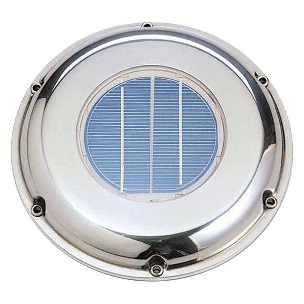

I just fitted a new (but kept in box for a year) 4" Marinco Day-Night Solar Vent to replace a ~10 year old Nicro solar vent. My new Marinco fan is working intermittently even under bright midday sun. I'm still checking to see if it is motor or battery issue. The LED Light is works just fine.
I may want to replace this Marinco with another make but it has to be a drop-in replacement. Could anyone recommend me another make of Solar Vent that fits the hole of Marinco 4" Solar Vent?

OK then another option is a $59 - 80 Pactrade Marine Boat Solar Powered Ventilator from Amazon OR $72 Solatron® SVT-224S - Stainless Steel Solar Ventilator with Rechargeable Battery. There are probably others. I suggest contacting Marinco for a replacement under warranty.

Another $100 option from Banggood is a E01988 Marine Stainless Steel Fan Deck Ventilator Portable Solar Powered No-noise Water Resistant Home Air Extractor Vent For Boat RV Roof Automatic. Personally I would stay with major suppliers such as Marinco or Nicro sold by US chandlers, BUT I have been known by myself, to buy off-brand products.
