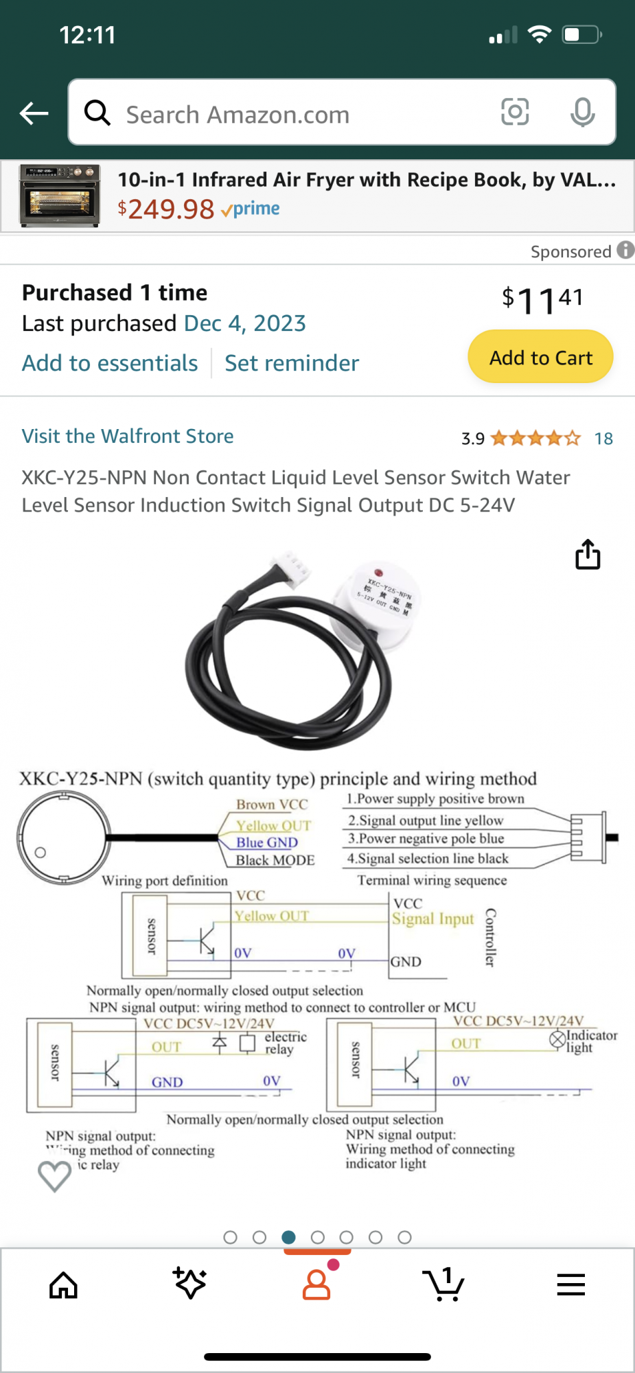

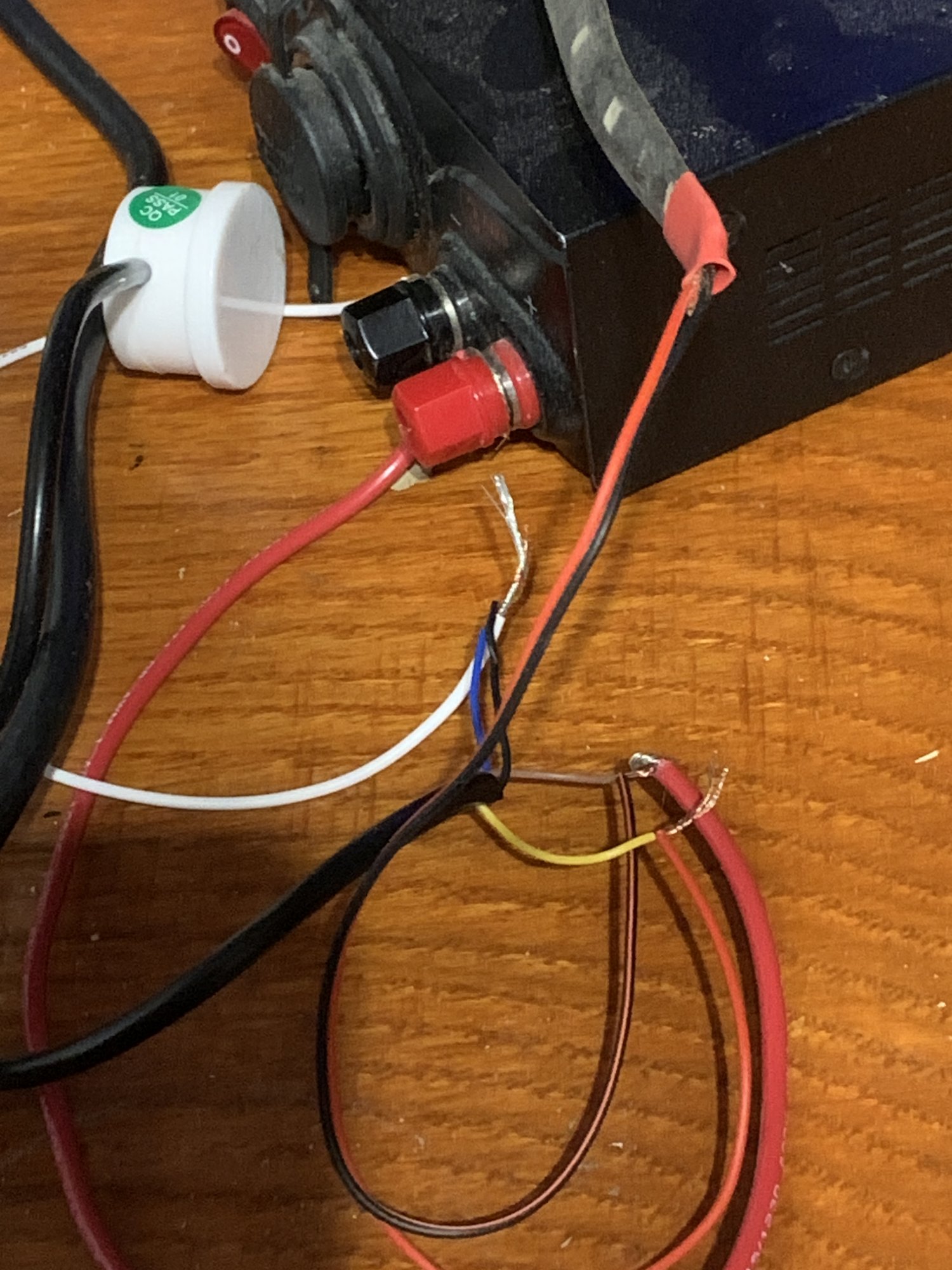

Yellow wire goes to negative side of external LED,
positive side of LED goes to power source,
brown wire goes to power source,
black and blue wires go to negative ground.
fiddled with it some more but still not working???

Yellow wire goes to negative side of external LED, positive side of LED goes to power source, brown wire goes to power source, black and blue wires go to negative ground.
thanks for the effort pal. If you're interested great if not of course I would understand. Thanks again!

Your LED may need a resistor wired into the circuit. That's getting a little above my pay grade but several online tutorials show something like a 200 ohm resistor.
interesting. Did you see the diagram that I sent which shows the way they recommend wiring the sensor?

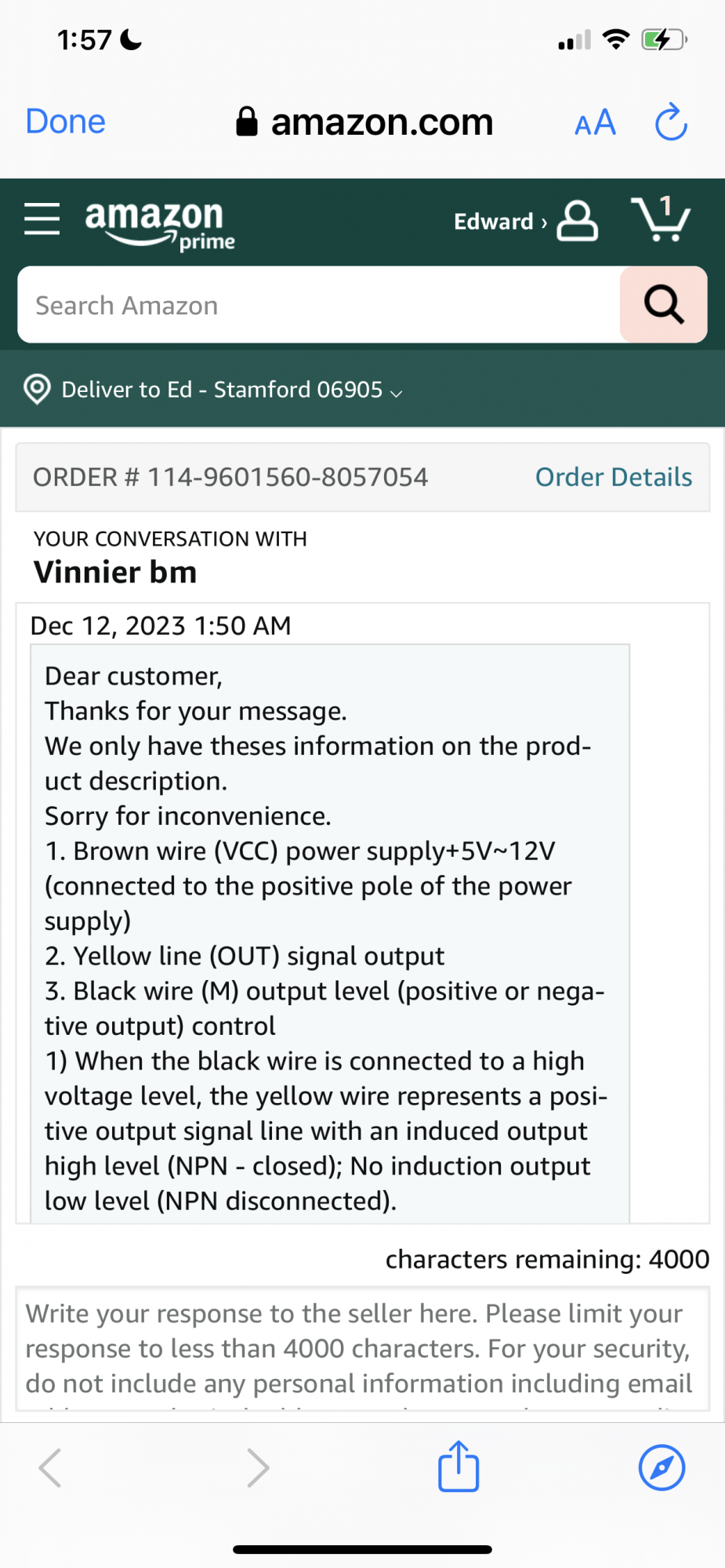

apparently it comes from the bowels of China. I've been in touch with the manufacture but they don't speak a lick of English it seems so communication is impossible.
