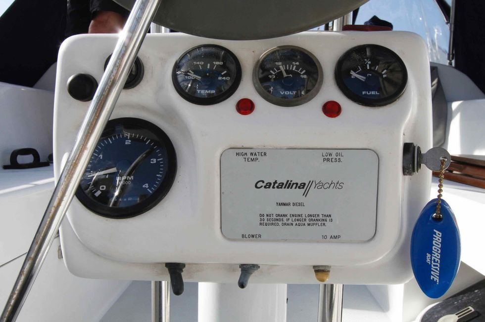

I have a yanmar 30 hp. Do you know if it has a system to vent air out of the boat? if it did I could simply turn on that ventilation system and it would suck air out of the main cabin through the engine compartment and out of the boat.
Yes it does, there is an exhaust fan inside port transom thru clamshell vent located there, on/off switch located on bottom of instrument pod (dependent on year and pod) which works when the ignition key is on. See switch below labeled "blower".

that's great! Do I have an ignition position that is on without an alarm going off? And can I use the blower independent of the motor? Thanks
Most likely, your blower is powered off the ignition switch and the alarm will sound (unless it is broken like my alarm was until I replaced it). If you want to run the blower without the ignition "on" you can probably wire it to a direct power source inside that panel.

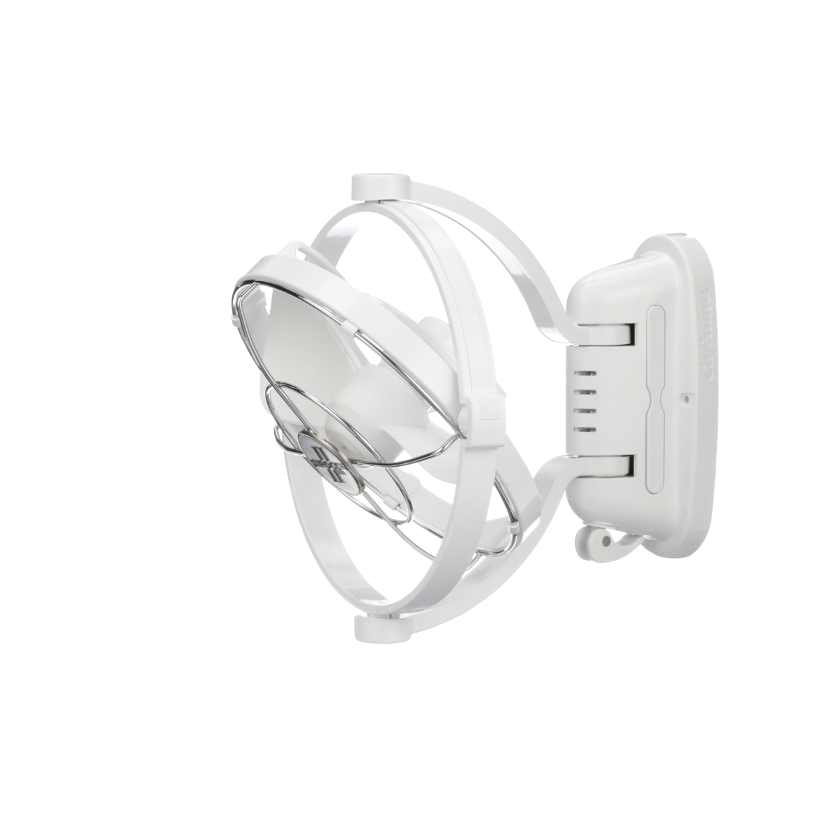

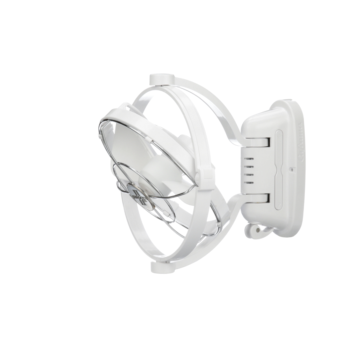

Perhaps, before cutting holes in the deck I would open one of the several hatches. You need air to move, get a fan in the space and point to blow air somewhere else in the boat. That will cause air from outside to be drawn in. This works in the air outside is cooler than the air inside the boat.
These SIROCCO II ELITE GIMBAL FAN 12V/24V, fans in White or Black are very nice.
