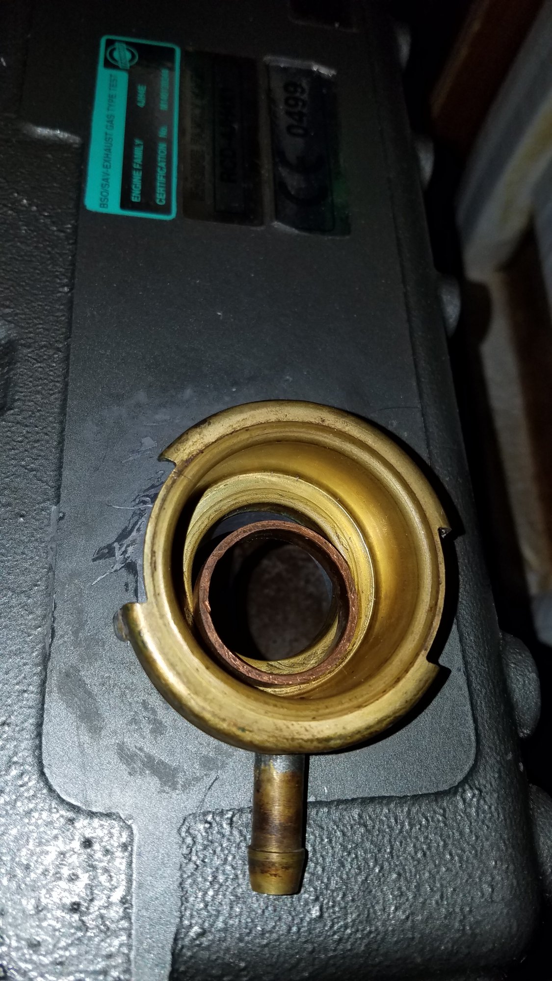

I chased that elusive leak for about 2 years. I tried the previous suggestions and some. It turns out when Yanmar produced the heat exchanger they press-fit the filler neck, Not welded or molded as one piece but pressed the filler neck into the heat exchanger.
there is a Global Technical Bulletin out for this repair GTB201004. I have the Yanmar 4jh4e and from what I can see they look the same. I will try and attach the Global Tech Bulletin but if it doesn't come through on my mobile app or you have further questions you can PM me.
