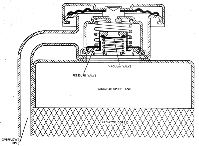

The way this works is that the radiator cap has two valves, a pressure valve and a vacuum valve. It has two seals, the outer cap seal, and the inner cap seal. It The outlet for the coolant recovery tank is between the two seals. Assume the cooling system is properly bled, and there is no air in it, or very little. When the engine heats up the coolant expands, and the excess causes a pressure increase; the pressure cap bleeds the excess pressure, by allowing coolant past the pressure valve, which then flows into the overflow tank. When the engine cools the coolant in the engine contracts. When this contraction results in a cooling system pressure below ambient pressure, coolant is sucked back into the cooling system from the overflow tank through the vacuum valve.
You should be able to see the hole for the overflow tube when you take off the radiator cap.

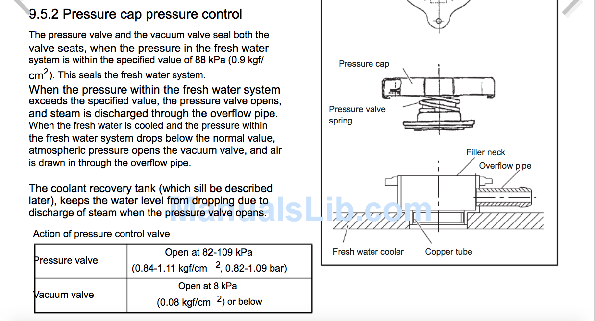

Can anyone tell me what the pressure rating of the heat exchanger tank cap (radiator cap) on a Yanmar 3YM20 should be? It has some kind of gunk on the rubber and the pressure rating is not marked on the cap.
Jun 22, 2017
4
Hunter Hunter Kemah,TX
That would be a great place for it but I don't see it there or in the cooling system section. About 7 pounds should be OK but just thought I'd ask.
jviss
Feb 5, 2004
7,090
Tartan 3800 20 Westport, MA

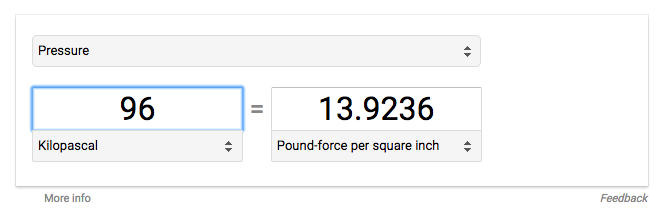

I was going to say 14 psi, as this is a common automotive and marine coolant pressure. I searched, and found this, on p. 181 of the Yanmar 3YM30 Sevice Manual:
The middle of 82 to 109 kPa is 96. Converting form there, and viola!
