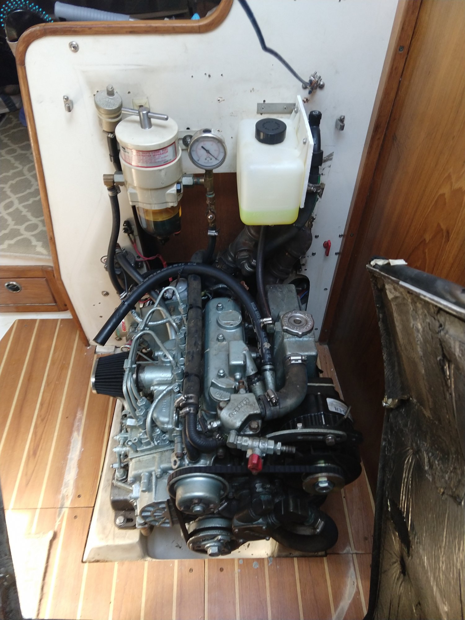

Yes. If you look at Mainesail's contribution to the C34 wiki (Stu's link), reply #14 it shows a better way to do it.
I just did mine for probably the 6th time since owning the boat two days ago. Since the 2nd time I have been doing the Mainesail system and have never had an issue.
In this pic you can see the improved vent. Because of the clearance on the steps I had to turn it side ways instead of up.
