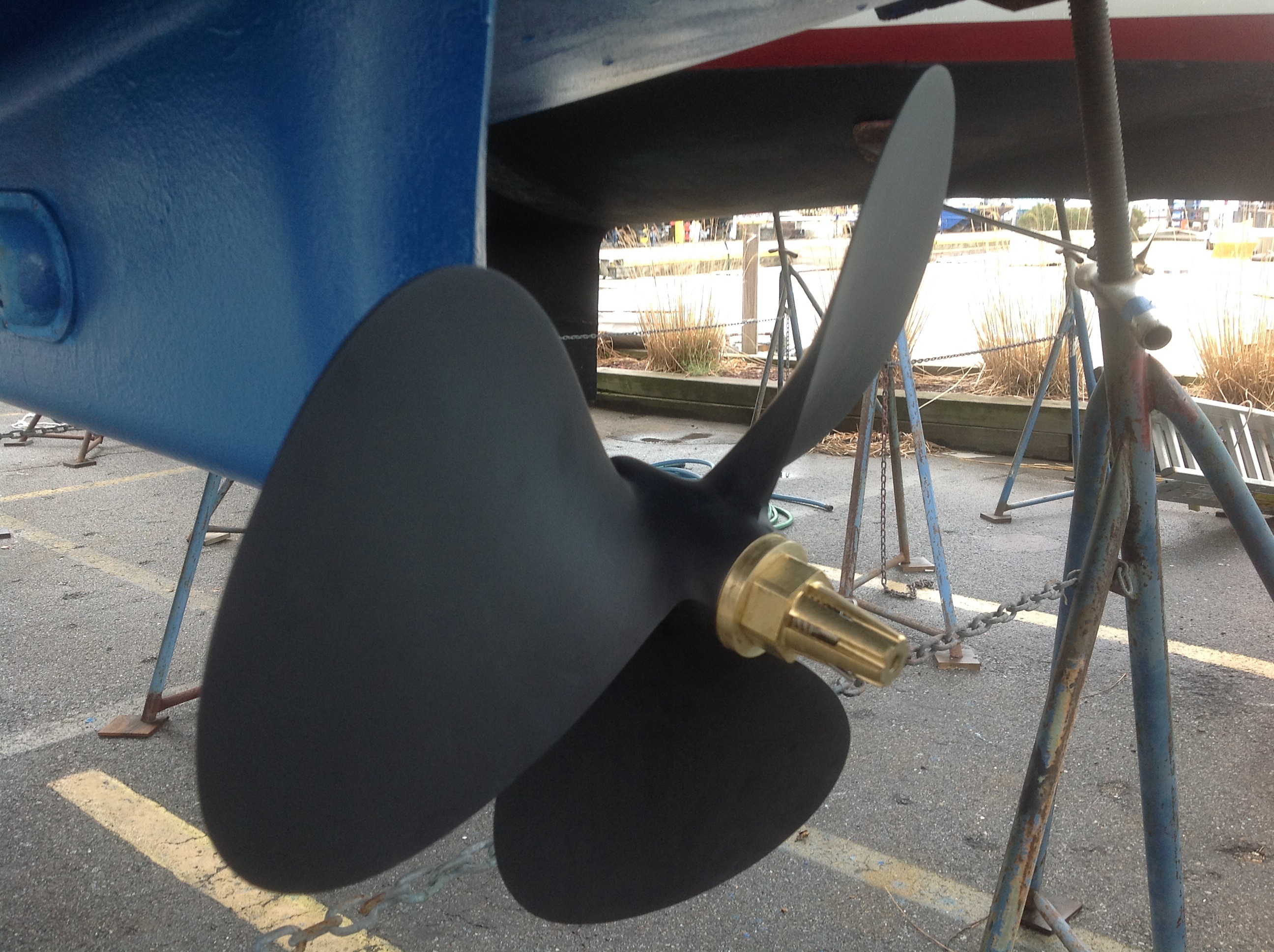

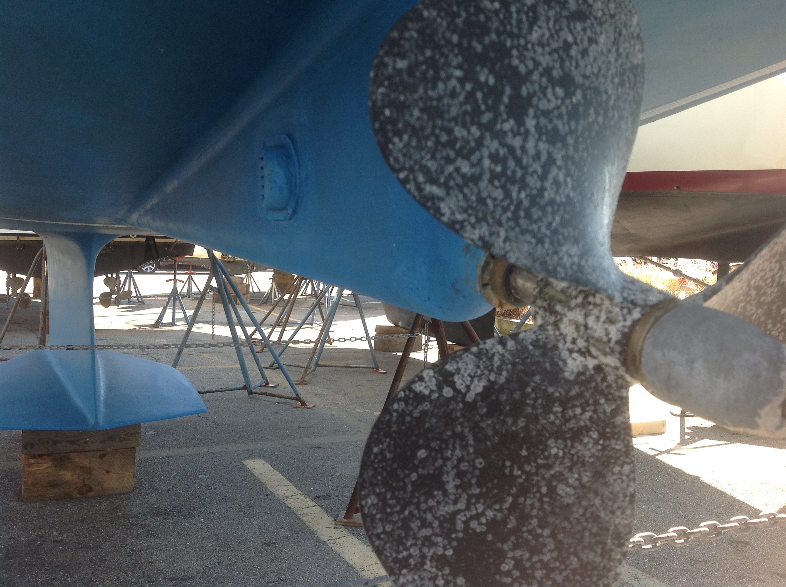

I have some experience with Velox and it is not good! Heading to the boat in a few minutes but will post pictures and details later tonight. I am going to share this experience with PS for one if there update articles on prop paints.
I have before and after pics, had the prop balanced and professionally applied at the prop shop so no way failure was due to improper application. I communicated with the vendor after my prop shop shared my concerns and there answer was less than acceptable....

This is why they were interested in my experience
Before and after one season, 6 months in Boston Harbor with regular bottom cleaning...

Solstice, thanks for posting the before/after prop photos with Velox. What are the white pox marks on the after photo? Is it electrolysis of the zinc in the Velox coating or discoloration from barnacles that were removed from the prop? Was there any permanent damage to the bronze prop?
If Velox has a high zinc content, should it not be used on the aluminum sail drive. The sail drive manufacturer warns not to coat the drive with copper based antifouling bottom paint because of electrolysis corrosion potential of the aluminum.
