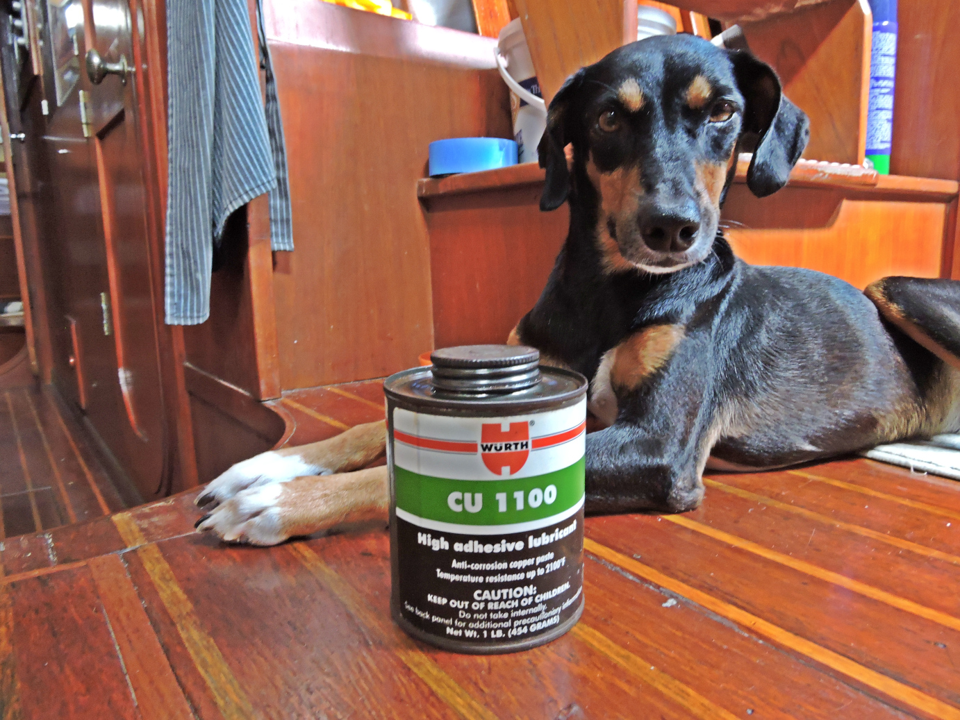

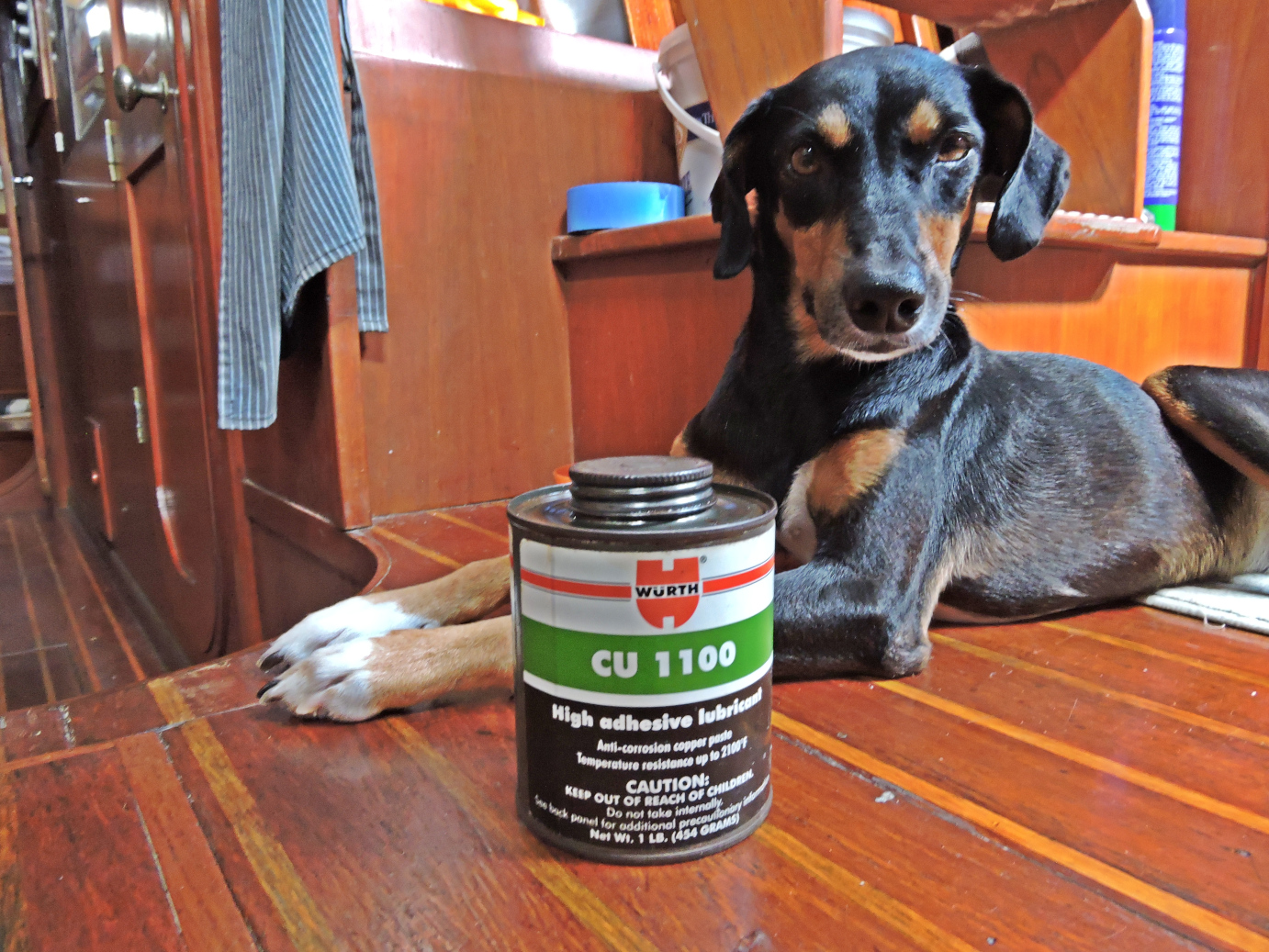

There are many types of commercial anti-seize products out there. The typical grey one is not for use on SS and aluminum but the copper colored and copper based anti-seize product, made by many companies, works for years and is rather inexpensive. The can we use, below, and we have dozens of S/S machine screws that we must remove and replace for maintenance of our IMRF system.
