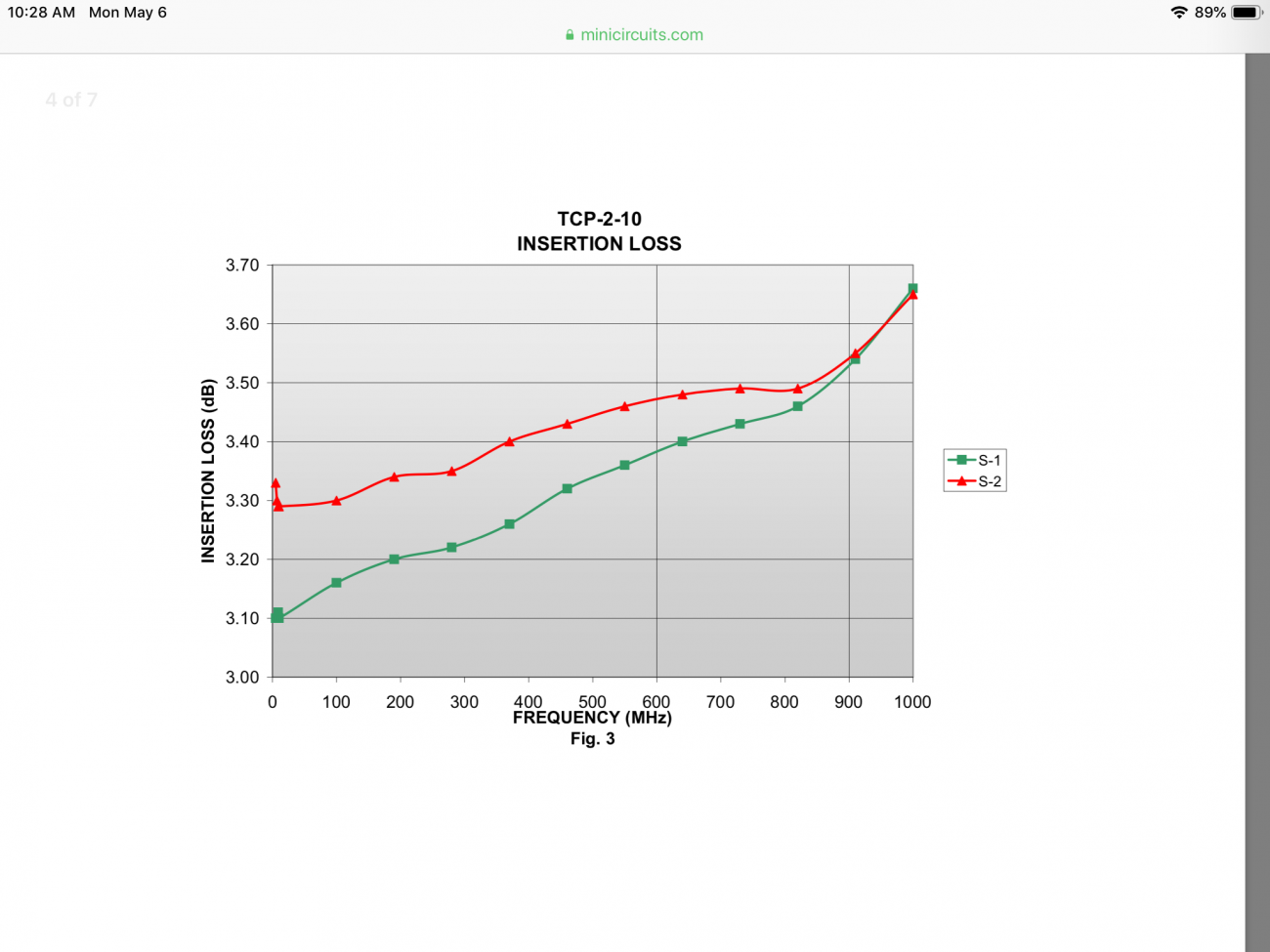

The typical loss expected from two common manufacturer splitters is depicted in the picture below:
Note the loss is minimum observed with a 1:1 SWR for new components still within tolerance, not subject to extended use, vibration, humidity or nearby magnetic fields, all of which can contribute to component failure not readily apparent. Failure doesn’t usually result in “letting the built-in smoke” escape the case.
