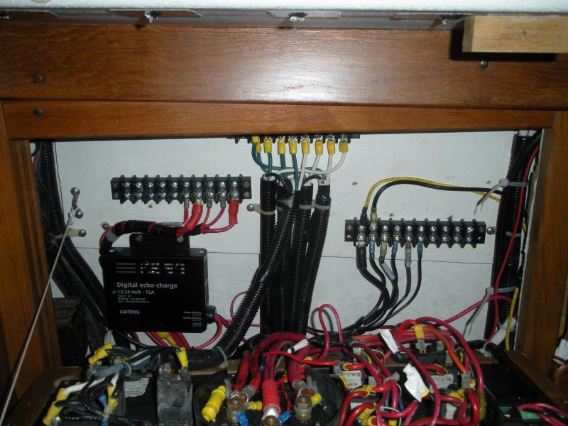

i have installed 3 of theses in the last year and i put them on the 1-both-2 switch...they all had #2 wire going from the switch to both batteries and so far there hasn't been any problems that i have found...i think as long as you hook it up to large cables you will not loose anything in the charging feater....
regards
woody
ps if i am doing this wrong...... i feel sure that some will help me correct it .....

I did the same as Woody four years ago with no problems
The nice thing about an Echo Charger or Duo Charger is that they can often be fitted directly behind a battery switch thus picking up the large gauge battery wiring. ACR's can too but often with the large gauge wiring you lack the room on the battery switch studs for the larger cables..
If you have a battery monitor just be sure the neg for the Echo is on the load side of the house bank shunt.
thanks for the tip...i have been lucky on all three as none had a monitor but i will be using one on my boat come panel wiring time in the near futer....
