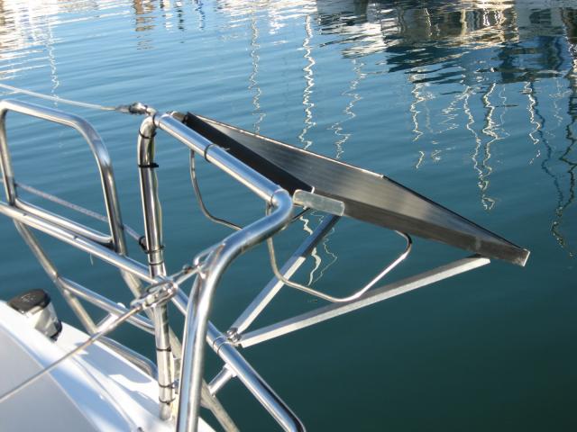

I'm entering this thread a bit late, but I would like to opine about a couple of items that I haven't seen mentioned re the Coleman type panels:
- I had a Coleman type panel to eventually discover that the glass was not tempered and the plastic frame was too flexible to be much protection from even mild abuse. Mostly my fault since I hadn't mounted it anywhere. Just stowed it away when I went out. One day, only about about 2" high from putting it down, it slipped from my hand and hit a corner first. With only a flexible plastic frame protecting it, it twisted and the glass broke. Other types of solar panels generally are made with tempered glass and are protected by a much more rigid anodized aluminum frame.
- From what I've observed, Coleman type panels are made with an older amorphous (non crystaline) silicon technology which is the least efficient type. Hence the size of the panel is about 2x's larger for a given wattage than if made with more recent monocrystalline silicon technology. The 20W monocrystalline panel that I bought to replace the one I broke is only about 15” x 16” vs the 14” x 39” of the Coleman 20W panel.
Here is a URL to a 20w monocrystalline panel with tempered glass: http://cgi.ebay.com/20w-solar-panel...emQQptZLH_DefaultDomain_0?hash=item3efa99a0b0
Attached is a photo of where my replacement panel (not Coleman type this time) is mounted. I don't do blue water sailing, so I'm not concerned about errant waves up the stern hitting it. The panel successfully keeps my two group 27 batteries and an emergency AGM battery charged without shore power between outings. But I’m not demanding much. Other than powering the 12v stereo system I have on board, no other drain is put on the batteries.
